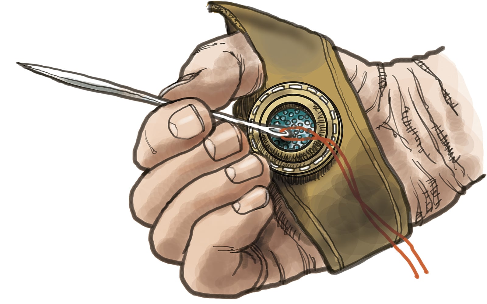

A sailmaker’s palm.
A sailmaker’s palm, needles, and waxed twine are indispensible in the proper care of cordage.

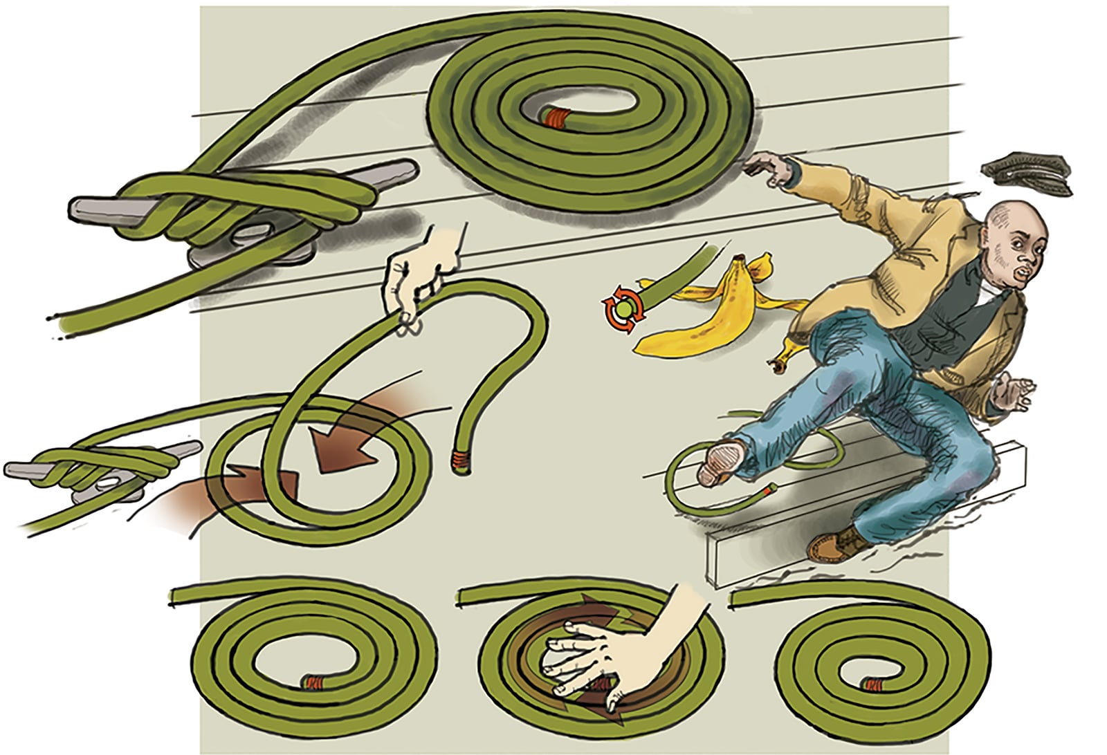

Good line is tight and generally round in cross-section. A random line’s end anywhere on deck or dock is a remarkably effective device for overcoming friction—that is, for shooting your nonskid boat shoes out from under you. A pratfall by the water is not funny. It’s a primary danger, and there are two ways to mitigate it: on your deck walkabout, deal with any line-ends accessible to feet. Second, lay down the flat Flemish flake, a tight flat spiral used on a stationary boat or on a dock. The flat flake is wound from the outside in, clockwise, then tightened into a compact, foot-friendly unit by “winding the clock” with a flattened hand. It’s not an over-fussy decoration; it’s a practical safety procedure.

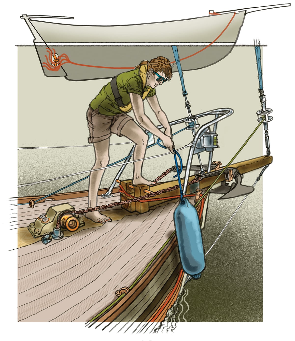

Fenders
Fenders

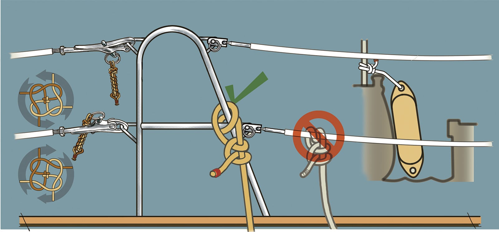

Your fenders and lifeline gate are prominent introductions to any visitor. Gates are often secured with pelican hooks or spring-shackle hooks. The latter require easily gripped lanyards. You will find hundreds of possibilities, but one humble example is the two-strand square sennit, which is simple enough for your children to fashion. It can be finished with West Country whipping. Fenders require care and cleaning. They should be secured by respectable line. They are not attached to lifelines but to stanchions or cleats, and they hang (in most cases, depending on your hull and the dock or boat to which you tie up) just short of the waterline. You’re the skipper: determine how you want your fenders tied off, and make it consistent for your crew: a round turn and two half-hitches is a common holdfast.

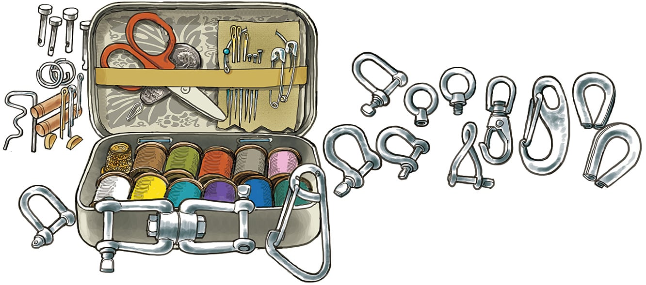

What you need in this so-called “ditty bag” varies widely. You may have more than a single bag, reserving tools for isolated tasks—setting grommets or stainless-steel cable work—in a dedicated box. You may have a separate bag for cordage and small stuff—twine, cord, hard small braid, etc. The basics for most line work are straightforward:
  • Marlinespike(s)
  • Sailmaker’s palm
  • Sail-repair tape for quick sail fixes
  • Masking tape for marking line, stabilizing strand or braid ends
  • Duct tape: you never know when you’ll need it
  • Thin, sharp Wharncliffe utility knife for cutting line cleanly
  • Long-nose butane lighter for fusing synthetic line ends

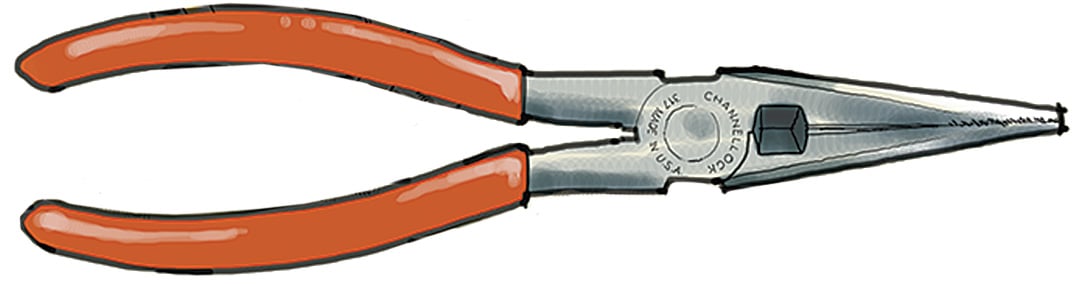

  • Needlenose pliers
  • Small wire clippers
  • Full-sized scissors and small detail scissors or thread snips
  • Nail clippers
  • Cake of beeswax
  • Sailmaker’s needles: a selection of sizes in a waterproof tube or box with desiccant
  • Whipping twine: a selection of colors and sizes
  • Hemostats (locking precision pliers), straight and curved
  • Monel or stainless-steel seizing wire for mousing shackles
  • Bungee cord and cord hooks
  • Spare cotter pins, shackle pins, nylon buckle parts, and split rings
  • Spare D, bow, and long-mouth screw-shackles in various sizes
  • Tape measure
  • Permanent marker
  • Double-sided hook-and-loop fastening
  • Common sewing gear
  • Selection of common, large-eye sewing needles, sharps and darning
  • Selection of polyester thread, small spools, in 9–12 colors
  • Needle threader
  • Curved upholstery needle
  • Common pins
  • Safety pins, various sizes
  • Thimble

Temperature variations and the pervasive humidity of a boat attack all your tools, especially delicate, articulated, edged, and pointed devices. Take pains to protect needles, pliers, carbon knives, and steel marlinespikes with a spray of lubricant or a desiccant packet within their bag.

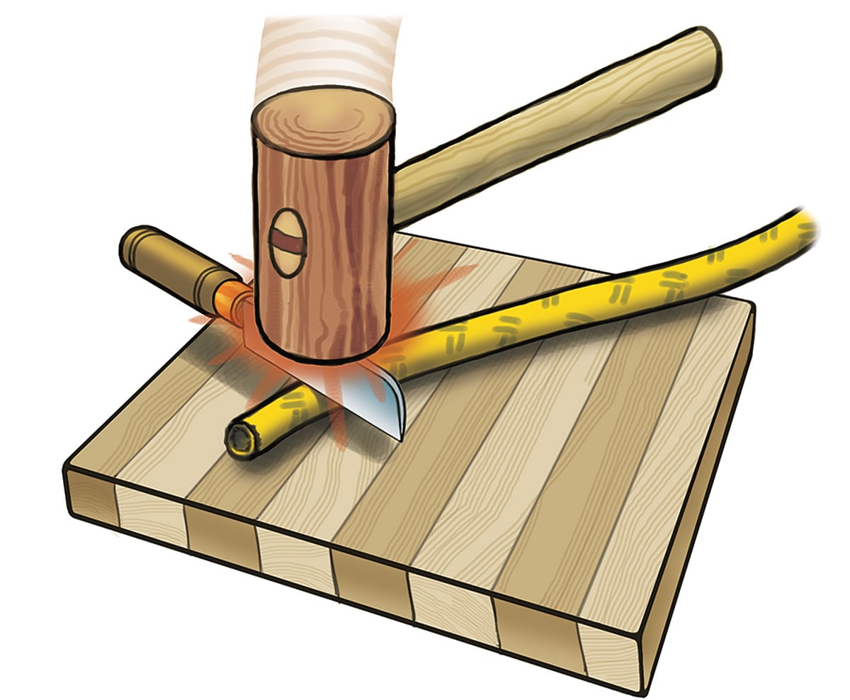

A quick blow from a mallet or hammer onto the back edge of a straight-bladed knife makes a clean cut in line, which must be set on top of a block of wood. The speed of the cut is crucial to preserving the line’s integrity.

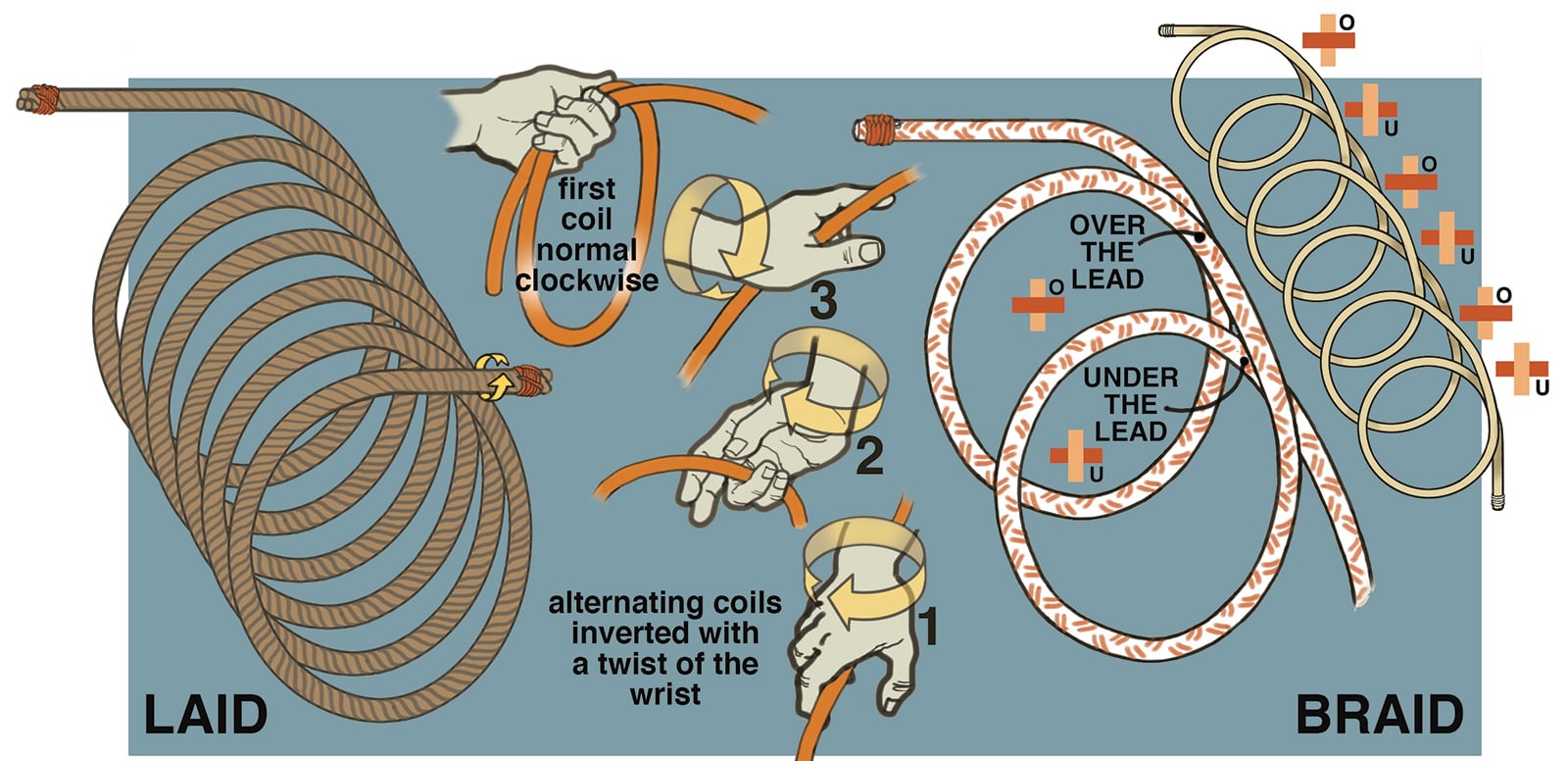

First, a basic difference in coiling laid and braided line. Laid line (“normal” Z or hawser-laid) is coiled clockwise, giving each turn a half-twist to keep the coil neat. Braided line is less forgiving of rotational forces. It is coiled more efficiently by alternating coils: normal clockwise loops, then “inverted” ones. We learned this from our rock n’ roll roadie friends who coiled speaker cables (which is even less rotationally forgiving) alternately. The first coil is picked up palm-in and coiled clockwise. The second coil is picked up with a hand turned palm-out, then twisted palm-in, up into the coil. Done this way, palm-in, palm-out, the braided coil will lie more neatly, uncoil more readily, and present fewer hockles.

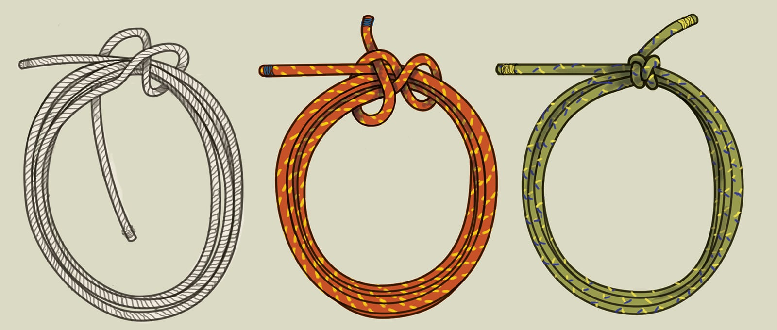

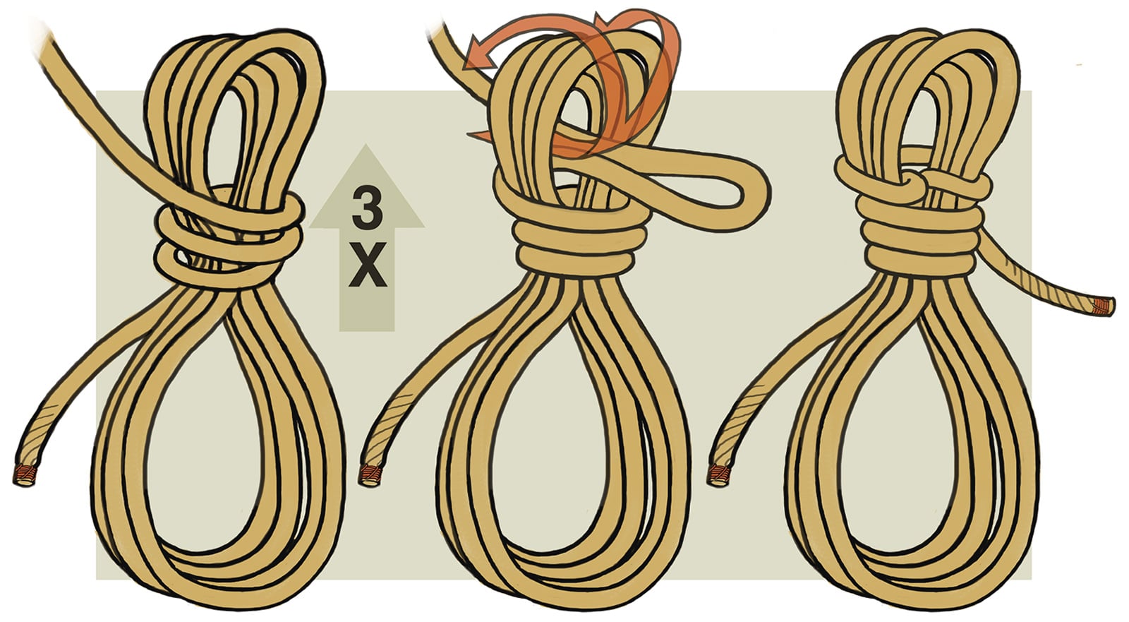

Once your coils are made—orderly and not too short, please, and never around the elbow—you have a choice of securing them. There are a number of ways of doing this, but very few function as well as the sea-gasket. Skippers may and should impose their preferences for order by making it clear that all line is stowed consistently. We prefer a three-turn sea-gasket, shown at left, so that someone coming from Jonah’s bunk can deploy the line quickly and easily, ready to use.

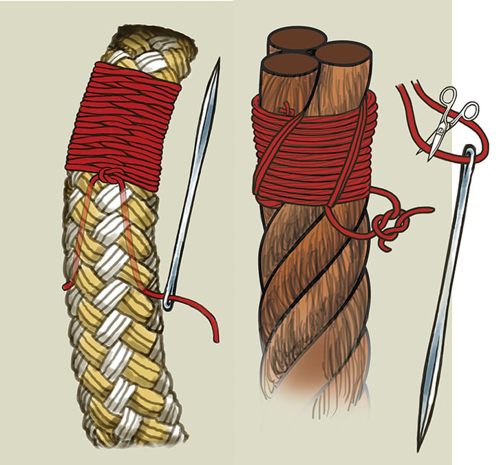

Proper Whipping
Proper whipping.
The weaving, twisting, counter-tensioning inner dynamic of rope has a distinct vulnerability at the bitter end, where the carefully crafted interplay can’t sustain itself and demands support where its continuum ceases: hence, whipping. Whipping not only “ends” your line cleanly but protects it, makes it more docile, and provides a stiffened lead through blocks or fairleads. A full treatment of how to execute a proper whipping will appear in the next installment of Getting Started in Boats.

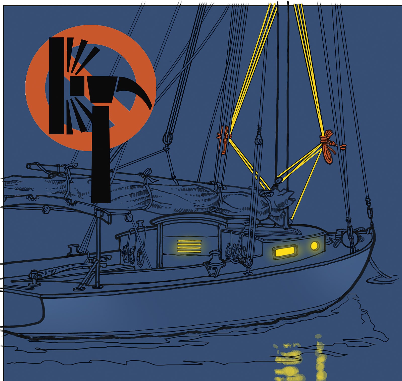

Nautical etiquette in an anchorage or boatyard is important. One piece of line-work etiquette is the “halyard wrench,” a length of line round-turned about main, mizzen, and jib halyards, holding them away from their mast so the vagrant wind doesn’t hammer out a sleep-spanking rhythm. Tethered to shrouds or stanchions, the halyard wrench (sometimes called a “gilguy”) can be tensioned and hitched against itself with a rolling hitch.

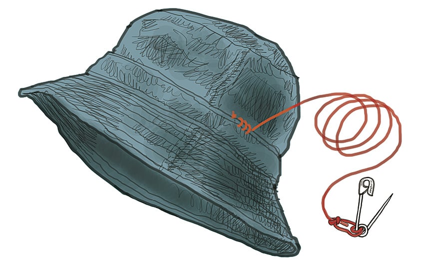

Securing Hats and Glasses
Securing hats.

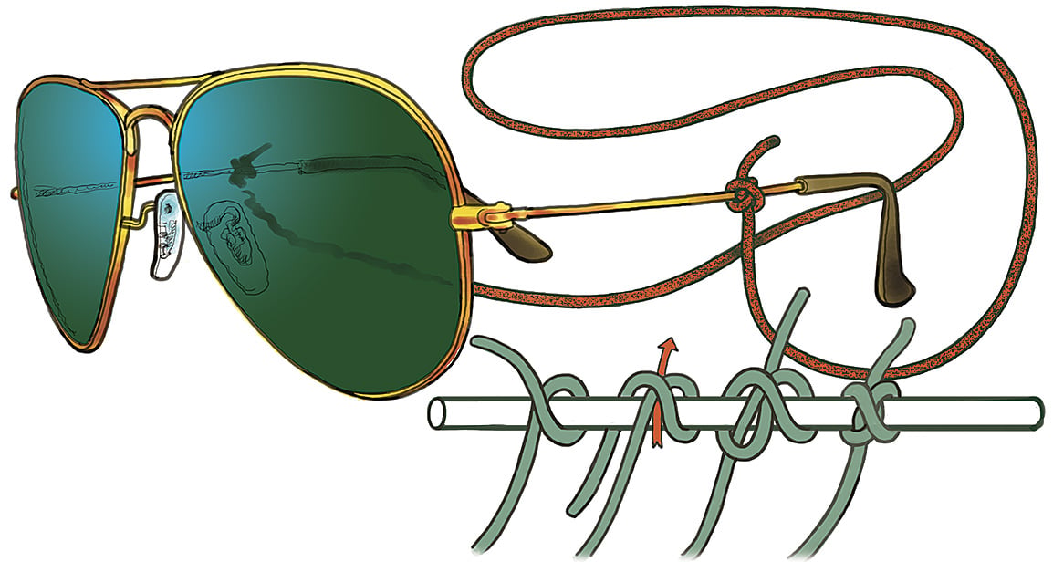

Two of the most uncomfortable items to lose overboard are hats and sunglasses. This is an excellent place to practice good line work. You may purchase a manufactured glasses-keeper, of course, but if you notice a crew member without this decoration, lay on a whipping twine keeper: clap on Ashley’s Constrictor Hitch (from the knot-tying tome The Ashley Book of Knots, by Clifford W. Ashley) to the temple pieces ahead of the ears. This aggressive hitch does not give up easily; you may find it simpler to cut it away after your sail. A few passes with a sailmaker’s needle with whipping twine will secure a hat; hitch the other end to a safety pin’s spring-eye and embed the pin more than once through a shirt collar.
Securing glasses.

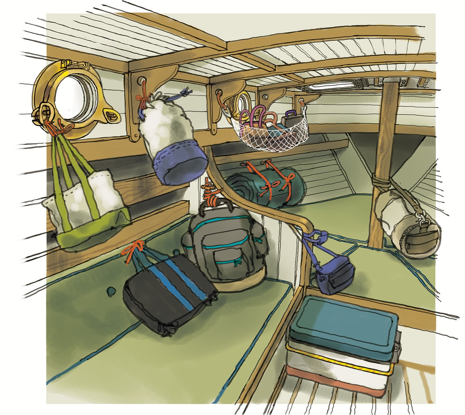

Securing the Cabin
Securing the cabin.
We can’t suggest specifics for stowing the gear your guests bring aboard, yet keeping the traffic pattern in the cabin uncluttered, and therefore safe, is essential. There are three working approaches to doing this with cordage: net “hammock” keepers, bungee cord, and small stuff (small-diameter cordage). All can be anchored by pad-eyes to stabilize duffels, backpacks, boat bags, coats, sleeping bags, and insulated hampers. Simple knots such as the round turn, the trucker’s hitch, and the rolling hitch will keep gear high and dry and out of the rush.
