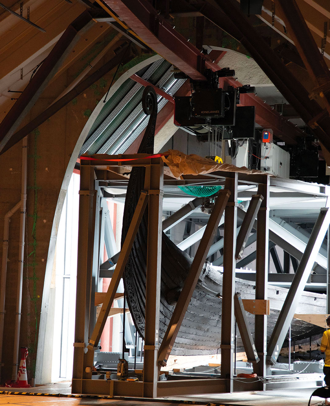

Courtesy of the Museum of the Viking Age
The intricately carved Oseberg ship was transferred on September 10 after a decade of planning for the technical challenge of safe transit.

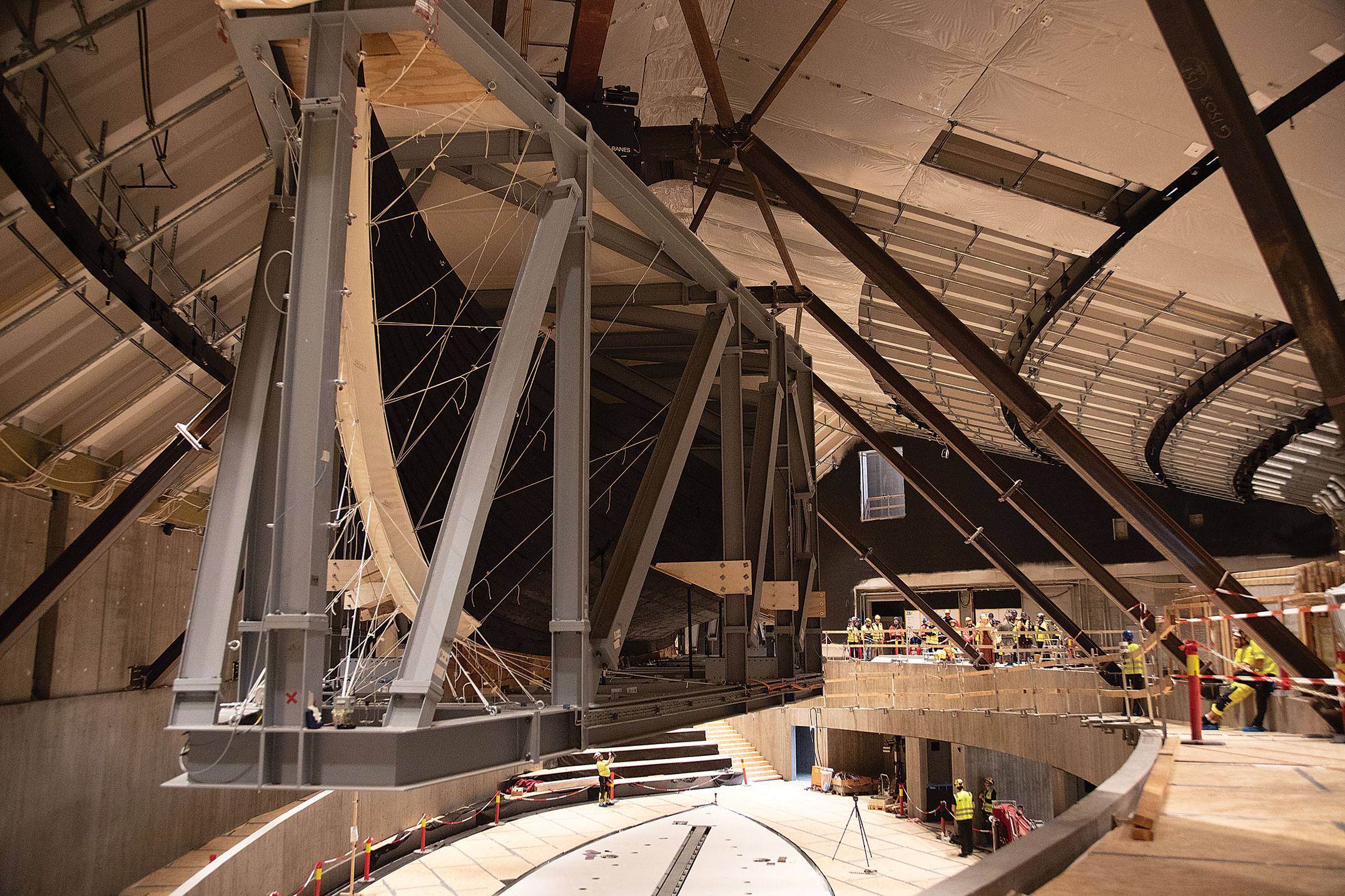

To do so, once the new building’s shell was completed an overhead steel rail system for rolling cranes was installed. Heavy support structures for the move were built specifically for each ship to keep movement within very narrow and strict parameters during the hoist. In September, the Oseberg ship was rolled 350′ to its new setting via the apse at a speed of about 10″ per minute; in Octoberthe Gokstad ship followedrolling 308′ via the transept. (See a time-lapse sequence of the move at the Museum of the Viking Age website.)
