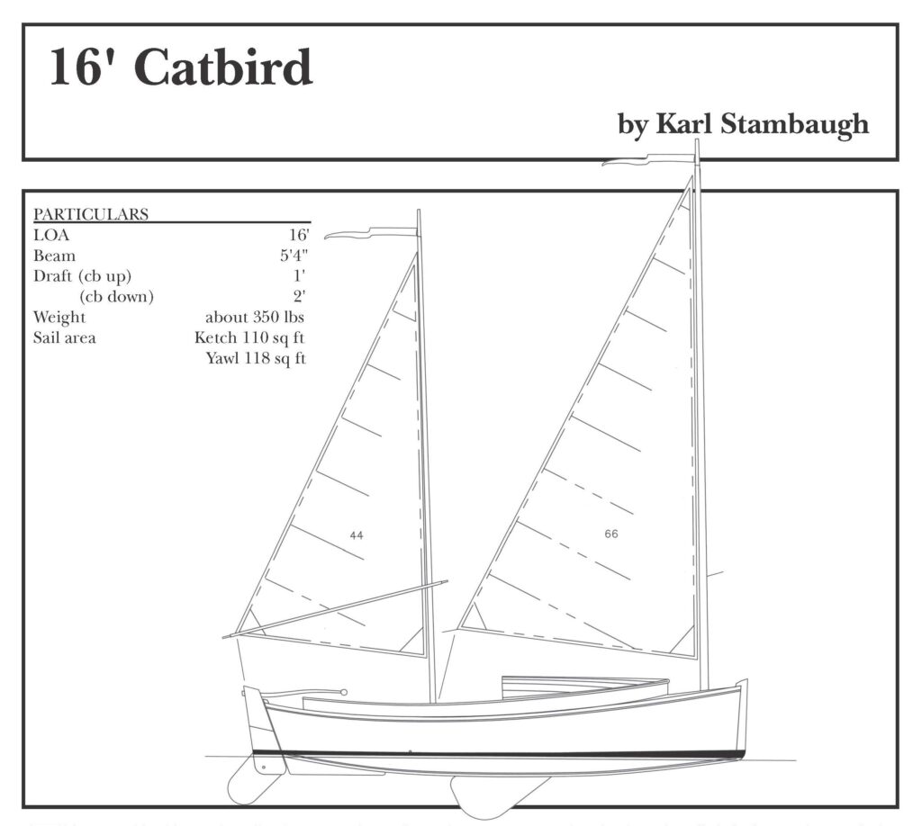

This good-looking daysailer/camp-cruiser floated from Karl Stambaugh’s drawing table along the shores of Chesapeake Bay. The versatile 16-footer will take us across fairly open water and, with only 6″ draft, far up secluded creeks on the other side.
16′ Catbird

Particulars
LOA:  16′
Beam:  5′4″
Draft:  (cb up) 1′
(cb down) 2′
Weight:  about 350 lbs
Sail area:  Ketch 110 sq ft, Yawl 118 sq ft
