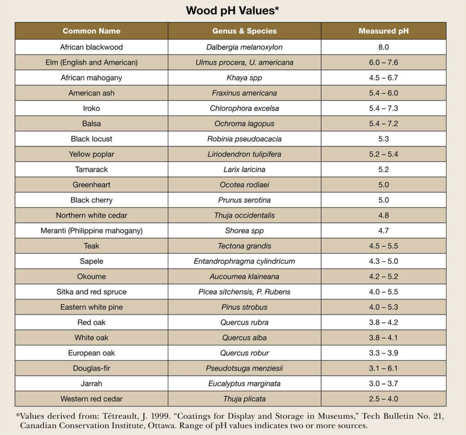

Table of wood PH valuesWith a range of 0 to 14, the pH scale is a measure of the acidity or alkalinity of a substance, with 7 representing the neutral zone. The scale is logarithmic, so a change from 5.0 to 4.0, for example, indicates a tenfold increase in acidity. The main components of wood are cellulose, lignin, and hemicellulose. Of these, hemicellulose is the most reactive. Acetyl esters on hemicellulose molecules can be hydrolyzed to produce acetic acid, which has a pH of about 2.4. Hemicellulose is found in concentrations of 4 to 6 percent in hardwoods and 1 to 2 percent in softwoods. This suggests that hardwoods should be more acidic, but the pH balance in wood is complex and can lead to some highly acidic softwoods.

In 1999, the Canadian Conservation Institute published a list of pH values of 88 woods that they had compiled from several sources. In the accompanying table, I have condensed that list to two dozen woods that might be used by boatbuilders. The pH values range from 8.0 in a tropical rosewood to 2.5 in western red cedar. Most woods are mildly acidic (pH 4 to 5, which is similar to tomato juice or black coffee). But oaks, Douglas-fir, at least one Australian eucalypt, and western red cedar are as acidic as orange juice or even vinegar.
Although the determination of wood acidity is not standardized, it is most often measured by mixing wood sawdust or other wood particulates with cold water and testing the pH after several minutes or a few hours of soaking. An alternate method substitutes hot water. Recently, piercing electrode meters, which are not unlike moisture meters, have been sometimes used. As a consequence, reported wood acidities can vary, depending on testing lab protocol. Additionally, fresh, green wood can have an acidity different from aged wood. Finally, acetic acid is the most common wood acid, and the most volatile, but formic, oxalic, and tannic acids are among the other acids that are present in amounts varying from very low to quite high. The pH values in the table reflect the totality of acids present in the wood at the time of measurement.
