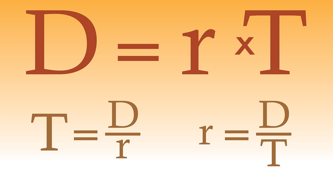

The basic formula, Distance = Rate × Time.
Basic low-visibility piloting requires knowledge of tidal currents. In New England waters, this information may be found in references such as the venerable Eldridge Tide and Pilot Book. It also may be found through direct observation—by, say, observing the speed and direction of the current as it flows past a buoy.
Course plotting requires some simple math to figure out how much a current will change—or set —your boat from its intended course. At the heart of the operation is the basic formula, Distance = Rate × Time. In order to travel 40 miles in 4 hours, we must travel at 10 knots. Distance (40) = Rate (10 knots) × Time (4 hours). Simple. We call it the “dirt” formula, as it’s typically shortened to D = rT.

Let’s say the boat is moving at 5 knots. The basic formula, D = rT, is recast as:
T=D ÷ r
Plugging in the numbers, we get:
T = 1.8nm ÷ 5k = 0.36h (the formula needs a decimal fraction of an hour)
