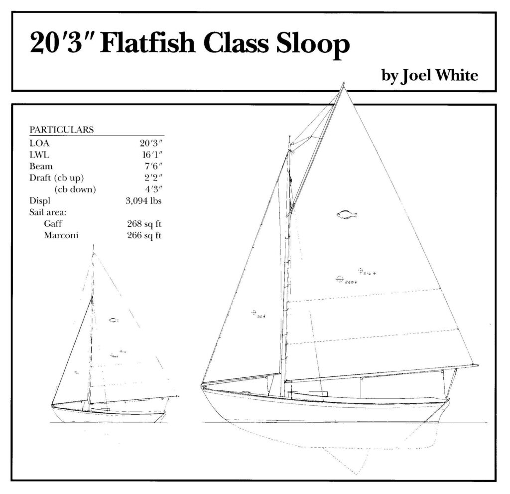

In 1986, WoodenBoat introduced the Haven 12½-footer, designer Joel White’s centerboard version of the Herreshoff 12½. These boats were so successful and the design so well received that Joel was persuaded to design a similar centerboard conversion of the Fish class boat which he named Flatfish.
20′3″ Flatfish Class Sloop
DESCRIPTION
Hull type: Round-bottomed, keel/centerboard
Rig: Gaff or marconi sloop
Construction: Carvel planed over steam-bent frames
PERFORMANCE
Suitable for somewhat protected waters
Intended capacity: 1-5 daysailing
Trailerable: Yes
Propulsion: Sail
BUILDING DATA
Skill needed: Advanced
Lofting required: Yes
PLANS DATA
No. of sheets: 6
Level of Detail: Average
Cost per set: $150
Plan No. 129
Related Publications:
Boat Design Quarterly, Vol. 14
How to Build the Haven 12 ½, by Maynard Bray
Particulars
LOA:  20′3″
LWL:  16′1″
Beam:  7′6″
Draft:  (db up) 2″2″
(db down) 4′3″
Displacement:  3094 lbs
Sail area:  Gaff 268 sq ft
Marconi 266 sq ft
