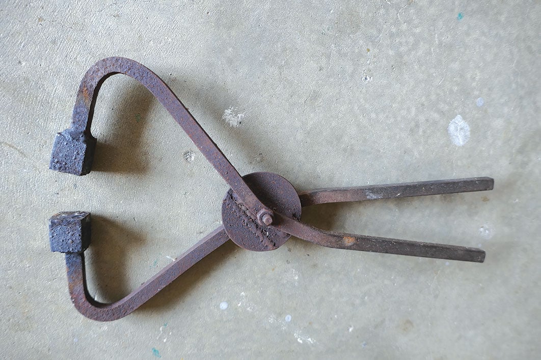

Iron tongs with a cube of steel welded to each end.

I read with interest the article by Harry Bryan in WB No. 306 in which he describes the repair of bandsaw blades. I often repair such blades, and use the same basic technique as Harry. However, I have found it difficult to control the heat when applying a flame directly to the blade, especially at the fine edge of the prepared blade. Above is a photograph of a pair of tongs that have a cube of steel welded to each end. These cubes are heated to the required temperature (dull red) and then clamped onto the blade secured in a jig with the silver-brazing alloy between the over-lapping blade ends.
