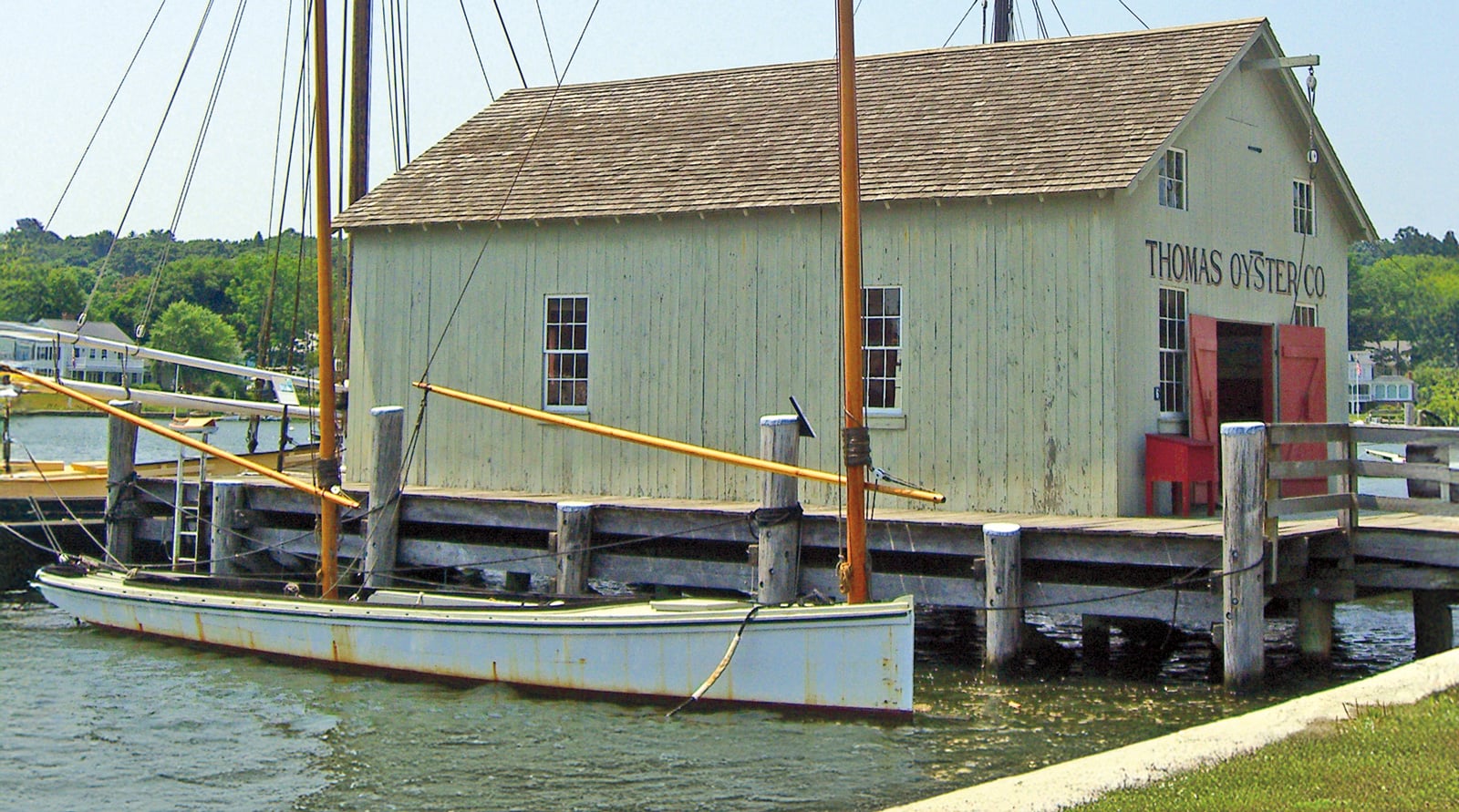

I have long admired these blue-collar craft and their nimbleness in shallow waters. Their performance is quite sporty, and it had to be: they are first cousins of sailing oyster-tonging working craft that people depended on to make a
living. When researching the design, I noticed on construction plans and period photographs that large working craft had oars and oarlocks, just as their diminutive offspring did. Clearly this was not the crowd to languish in the bay with a cocktail waiting for the breeze to return, and breaking out a smartphone to call for a tow was not an option.

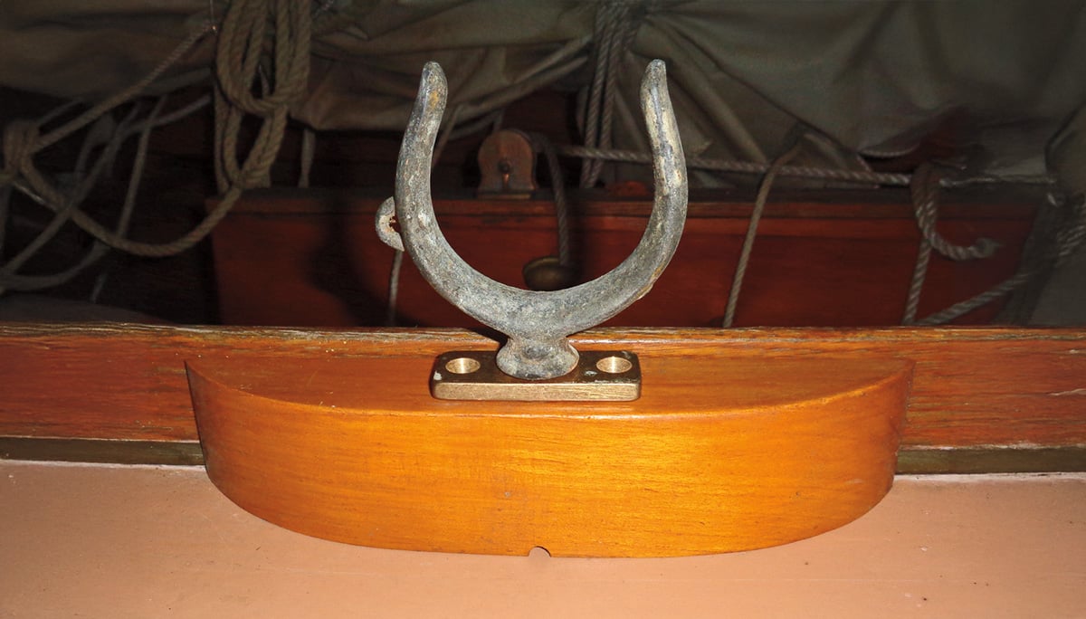

There are three options for getting oarlocks up and over the top edge of coamings to allow the use of oars while seated: (1) a traditional on-the-deck raised pad, which allows oarlock placement farther out from the centerline of the hull (these present a tripping hazard and possible gear snag; (2) a purchased pair of specialty tall “standing” oarlock horns paired with oarlock sockets ruggedly set into the deck (these specialty items are pricey and hard to find in a pinch; Duck Trap Woodworking sells a very handsome set; (3) a deck-and-coaming mounted raised pad that accepts standard oarlock horns. On a recent project of mine, the third option seemed the best: one that’s rugged and unobtrusive and would offer reinforcement to the coamings.

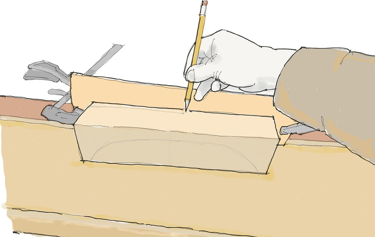

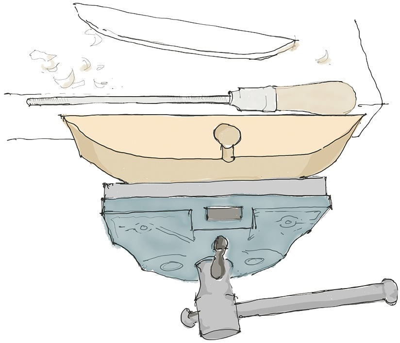

Scribe the curvature of the coaming onto the pad stock to provide a cut line for the inner face of the block. Because your rough stock will likely be taller than the coaming, clamp a piece of ¼″ plywood to the coaming to extend its curve upward. Scribe the shape onto the stock with a pencil and saw this curve into the block. To help get a tight fit, rub a bit of line chalk onto the coaming and press and slide the curve of the sawn block against it. The chalk will mark the high points of the curve. Remove those imperfections with a spokeshave and repeat the process until the entirety of the curve has a uniform chalked appearance.

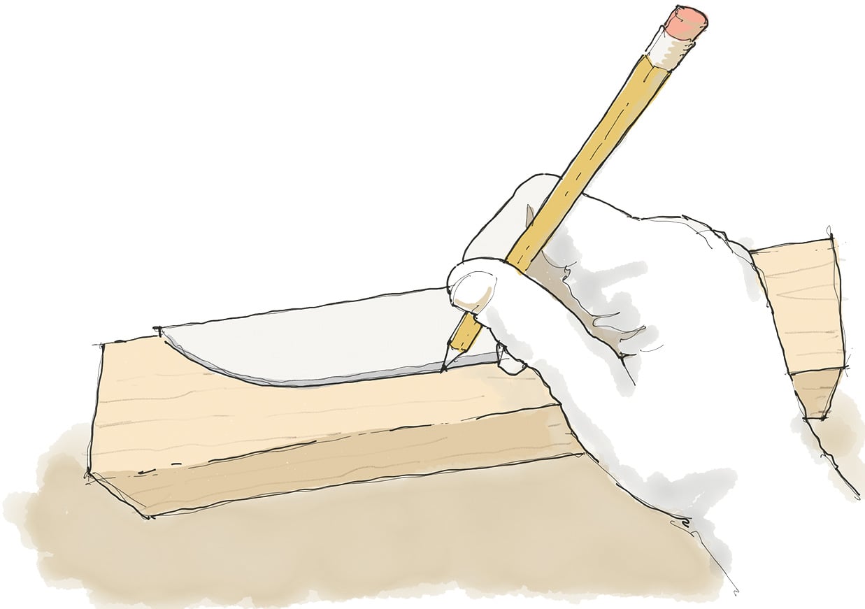

Place the pattern atop the pad stock and trace the oval shape onto the wood—but don’t cut it yet. (This pattern can be used for the opposite side of the boat by flipping it over to create a mirror-image.)

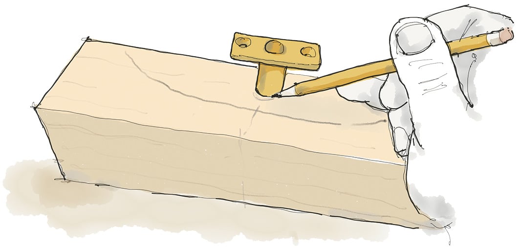

Drill for the socket

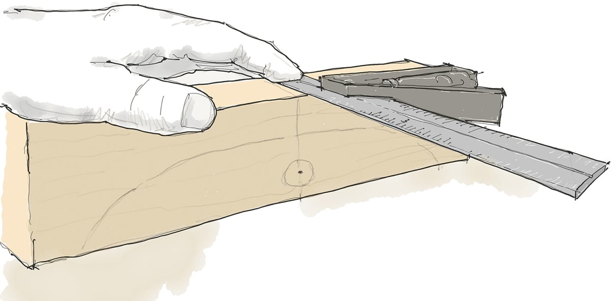

To determine the location of the long bore for the shaft of the oarlock socket, stand the socket at its location and trace the circumference of the socket. It will likely be approximately ¾″ in diameter. Using a tri-square on the top face, draw a line through the center of the circular socket hole.
Square this line down both sides of the stock and connect them across the bottom. Register the distance of the center of the socket hole from the edge of the stock on the top face onto the bottom face.

After fitting the pad to the deck, place it next to the coaming to trace the top curve of the coaming onto the still-tall stock. Saw or plane off the excess. The oarlock socket can now be fitted to the top of the pad and its screw holes drilled. To prevent the bored hole pad becoming a water trap after being affixed to the deck, use a rat-tail file to cut a U-shaped limber channel into its bottom face between the hole and the outboard face. Sand and varnish all surfaces to taste.
