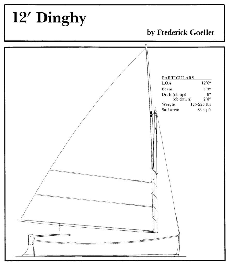

L. Francis Herreshoff felt that Frederick Goeller was one of the best draftsmen that he knew, and Mr. Goeller proved his design ability when he came up with this boat that will row, sail, and handle an outboard motor, plus be strong, beautiful, and practical at the same time.
12′ Goeller Dinghy
DESCRIPTION
Hull type: Round-bottomed, transom stern, centerboard
Rig: Single sliding gunter
Construction: Carvel-planked over steamed frames
Alternative construction: Lapstrake, strip, or cold-molded
PERFORMANCE
Suitable for: Protected waters
Intended capacity: 2-4 daysailing
Trailerable: With difficulty
Propulsion: Sail, oars, outboard
Speed (knots): 2-4
BUILDING DATA
Skill needed: Intermediate
Lofting required: Yes
PLANS DATA
No. of sheets: 3
Level of Detail: Average
Cost per set: $40
Plan No. 10
Related Publications:
WoodenBoat No. 25
Boat Design Quarterly, Vol. 17
Particulars
LOA:  22′
LWL:  19′6″
Beam:  6′1″
Draft:  3′3″
Displacement:  1955 lbs
Sail area:  160 sq ft
