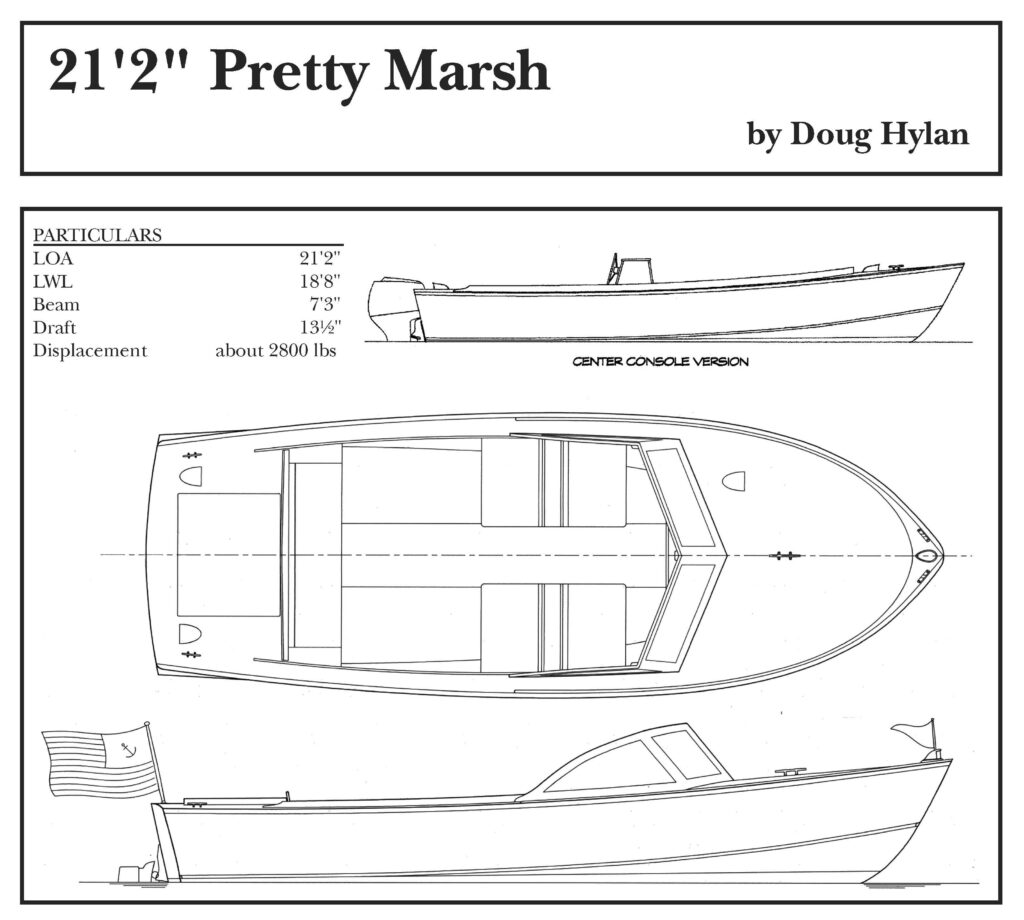

This shapely powerboat belies her relatively easy construction. Her bottom is planked with two layers of plywood for a good combination of fast building and complex shape. A wide chine built up of plywood eases the hard corner found on most vee-bottom boats into a narrow flat, and her topsides are strip-planked to allow graceful bow flare and tumblehome in the quarters. She employs only a few sawn frames in the bow sections to help define that shapely region; the majority of her framing runs longitudinally for a clean, easy-to-maintain interior.
21′2″ Pretty Marsh Runabout
DESCRIPTION
Hull type: V-bottomed, transom sterned
Construction: Strip-planking and plywood
PERFORMANCE
Suitable for semi-protected waters
Intended capacity: 1-6
Trailerable
Propulsion: 80–200-hp, outboard, or inboard/outboard
BUILDING DATA
Skill needed: Advanced
Lofting required: Yes
PLANS DATA
No. of sheets: 5
Supplemental information: 6 pages
Plans Format: Print
Cost per set: $120
Plan No. 142
Related Publications:
WoodenBoat No. 148
Particulars
LOA:  21’2″
LWL:  18’8″
Beam:  7’3″
Draft:  13½”
Displacement:  about 2800 lbs
