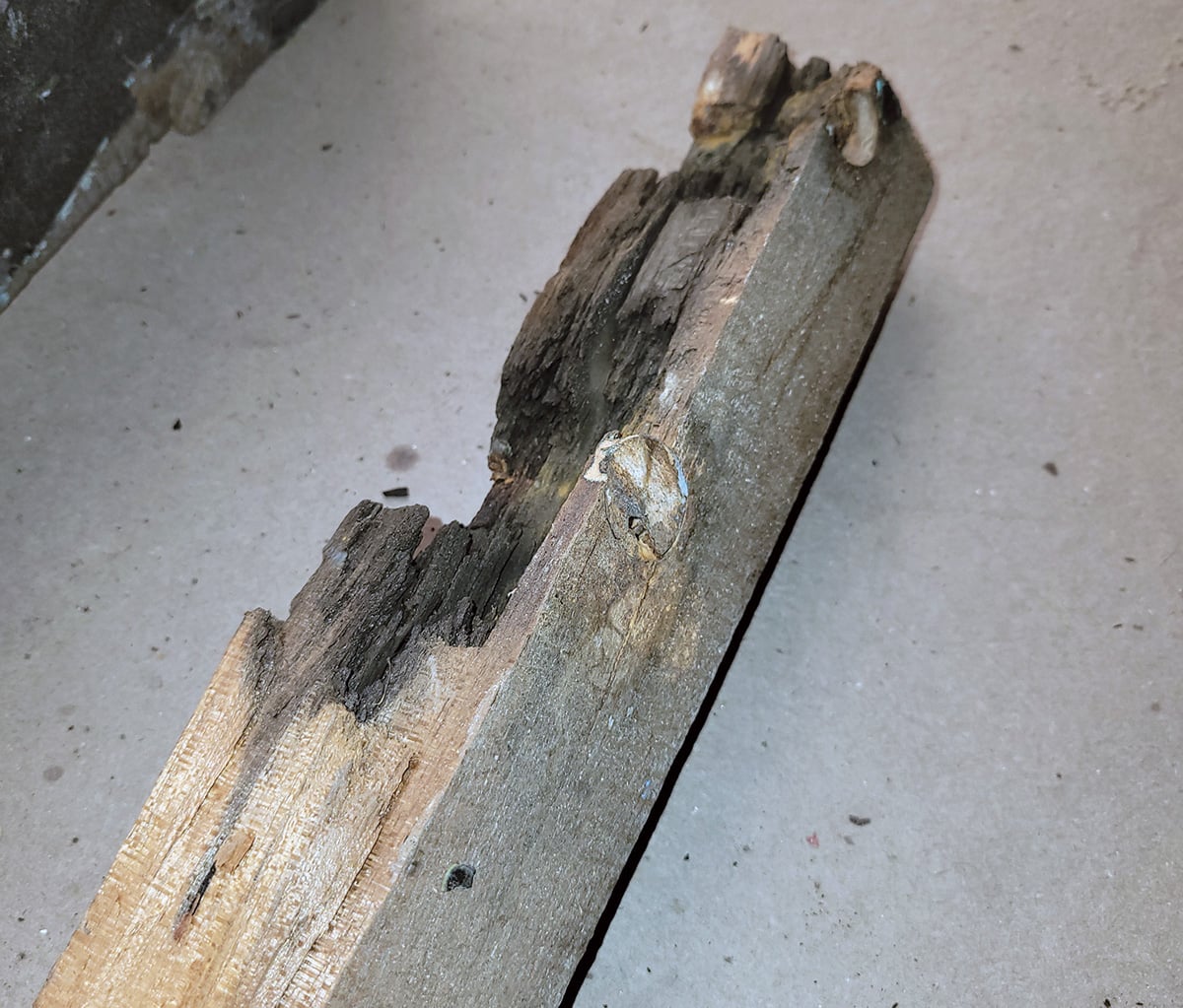

A segment of courbaril planking.Courtesy of Mystic Seaport Museum
This segment of courbaril planking displays a sound exterior surface. Pale colored end-grain, with a slight pinkish cast, is indicative of sapwood.

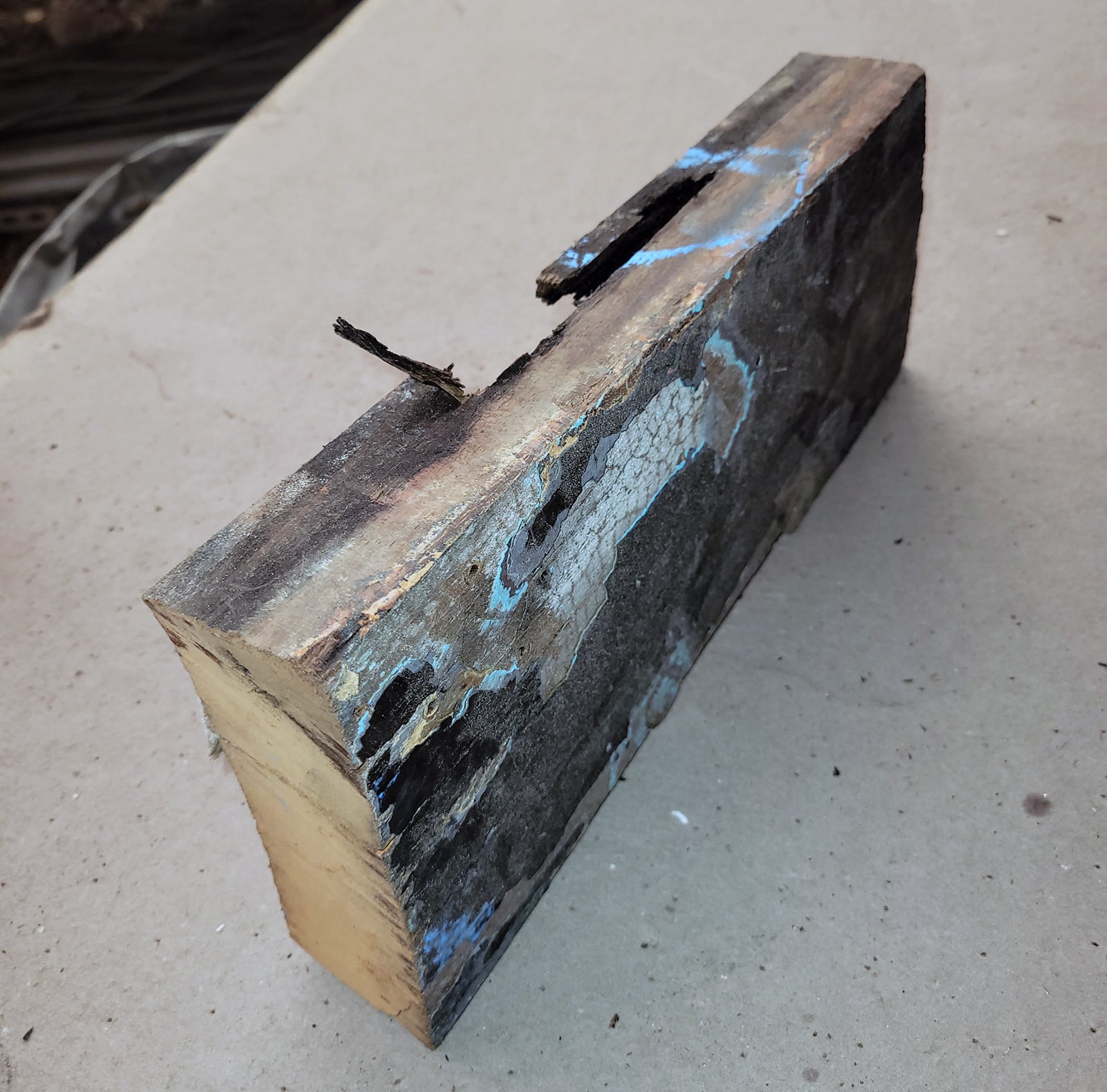

Extensive brown rot.Courtesy of Mystic Seaport Museum
Extensive brown rot, initiating from the upper plank edge, can be seen in this inner surface of courbaril planking.
White-rot fungi attack the lignin in wood, exposing stringy white cellulose, while brown-rot fungi digest cellulose, leaving a brown, crumbly, lignin-rich residue. In boats, brown rot is by far the prevalent form of decay, and this is what we see in the two photos.

Finally, no matter what wood species is chosen, a thorough examination of the delivered timber can avoid later problems. Courbaril heartwood is known to have a color that ranges from bright orange to reddish brown when fresh, darkening to deep reddish brown over time. The sapwood is whitish to pale gray with, sometimes, a pinkish hue. At least some of the wood in the photos appears, to me, to be sapwood—which for any species lacks decay resistance.
