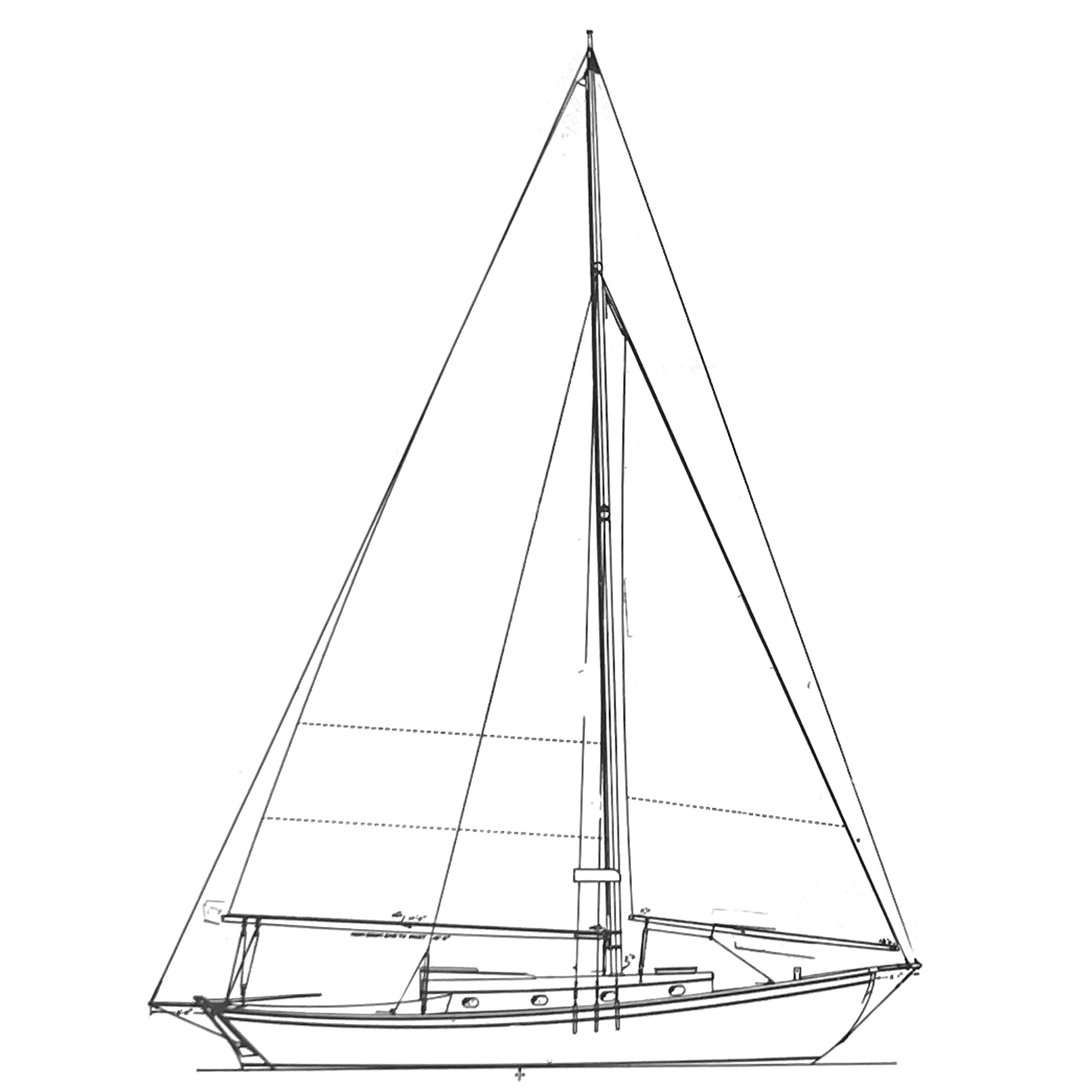

The Concordia 31 sail plan (shown here as published in Waldo Howland’s A Life in Boats) was reduced for the 25-footer’s similar rig.

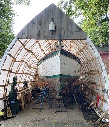

David KellyThe sloop JEANNE, a 25′ scaled-down version of the Concordia 31, was built in New Bedford, Massachusetts, in 1940. She is now stored out of the weather in a bow shed in Warren, Maine.

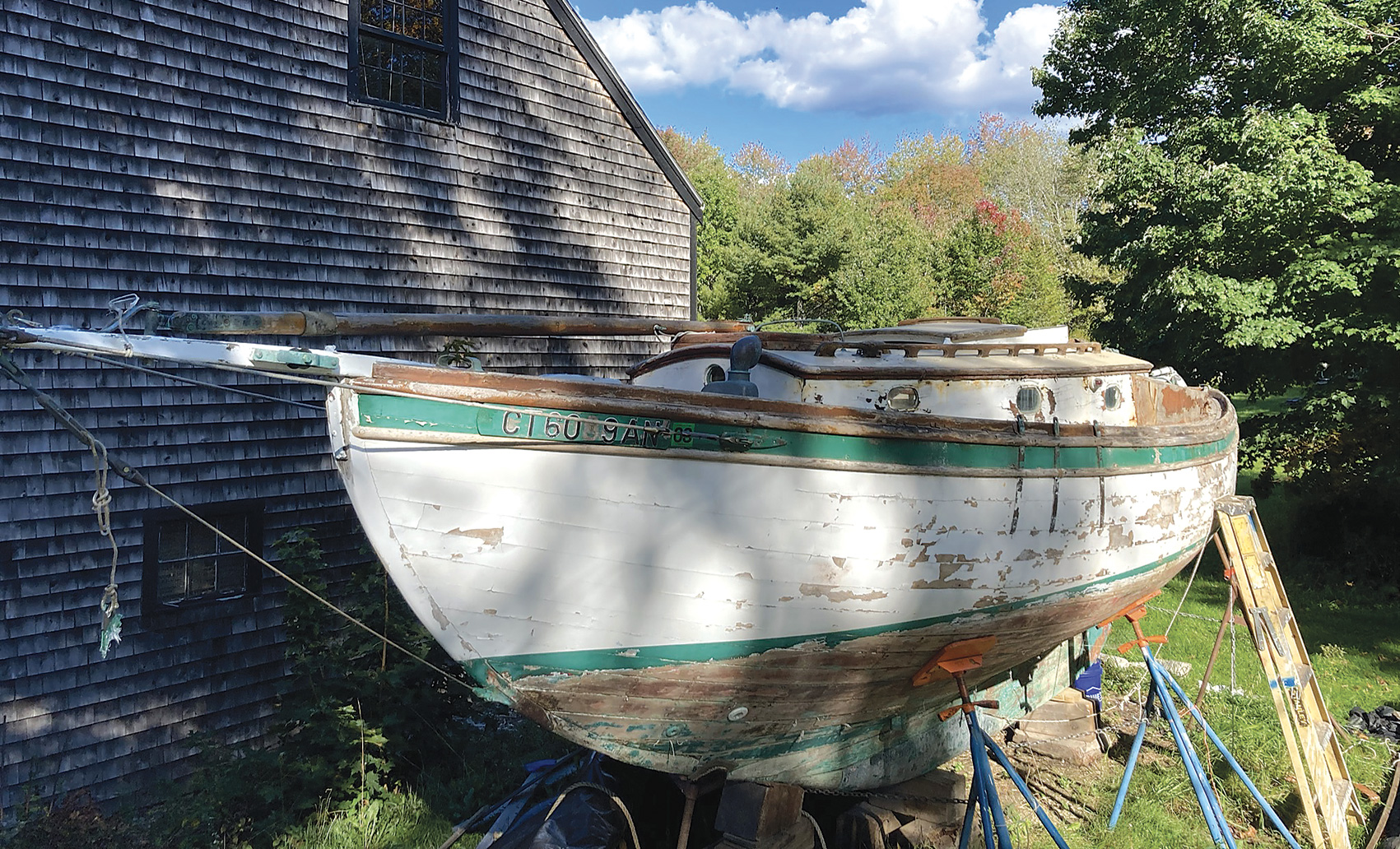

Despite her present owner having made a significant start on her needs, there’s still a good deal of work ahead. With a teak-sheathed deck that’s serviceable and an intact interior that should remain, this hull is a perfect candidate for resheathing—either with diagonal wood veneers or with high-strength fiberglass cloth, using epoxy as the adhesive in either case. This treatment has proven to be a “standard fix” for worn-out plank-on-frame hulls when a boat’s original steam-bent frames just don’t have their original strength because of breakage or rot, sistered-frame repairs are failing, or her planking has dried out and its fastenings are beginning to lose their grip. So, you grind down to bare wood, fair the hull, then sheathe it with wood or ’glass, whichever suits your fancy. You’ll find techniques and guidance in WoodenBoat articles, Off Center Harbor videos, and Allan Vaitses’s classic book Covering Wooden Boats with Fiberglass. It’s a heresy, for sure, among traditionalists, but it’s a chance to recycle rather than trash a boat that’s economically beyond a pure restoration.
Afterward, you’ll have a strong and lovely little boat that doesn’t leak. Her spars and rig are okay, and she has brand-new engine bedlogs and a variety of other recent upgrades. She has a lead ballast keel, bronze hardware, and spruce spars with stainless-steel rigging. Her sails range from fair to excellent.

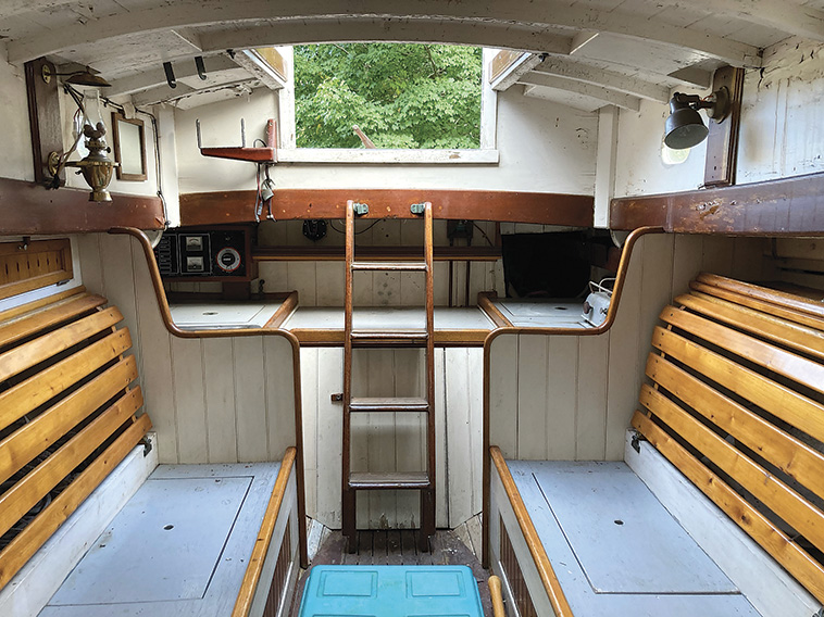

David KellyThe cabin has a full-width galley extending under the bridge deck, and the classic Concordia-style settee backs fold down to make berths. The head is forward of the main saloon bulkhead, along with a pipe berth.
The owner has acquired another boat and is ready to pass this one on to a person who sees her potential and can continue the restoration. She’s presently inside a plastic shed at her owner’s home in Warren, Maine.
