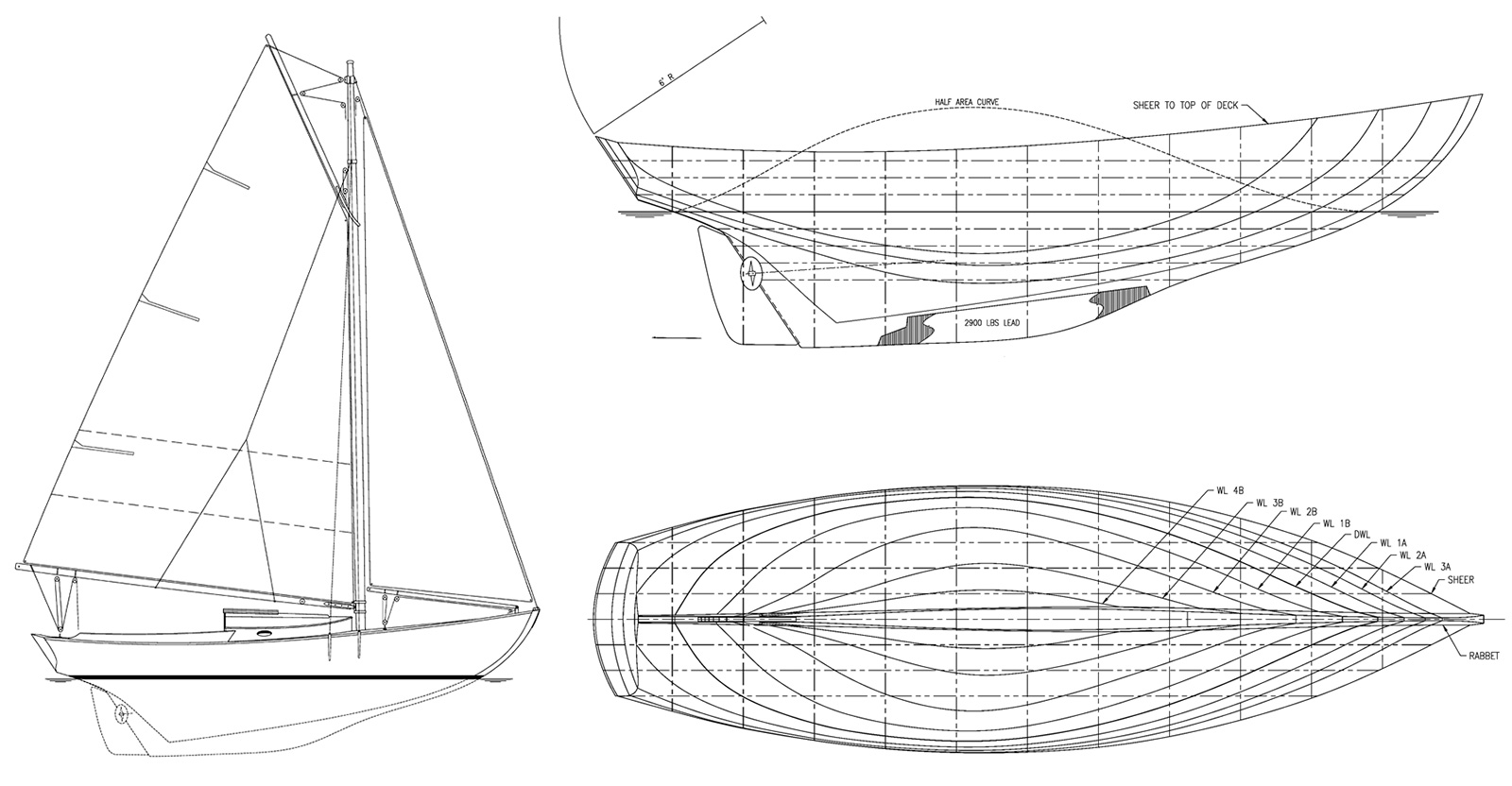

Marta’s hull lines show a lot of pleasing shape. The sheerline sweeps down smoothly to Station 7, where it turns up strongly and heads aft to meet the transom. This sheer will never appear to go flat aft, no matter from what angle we might view it.

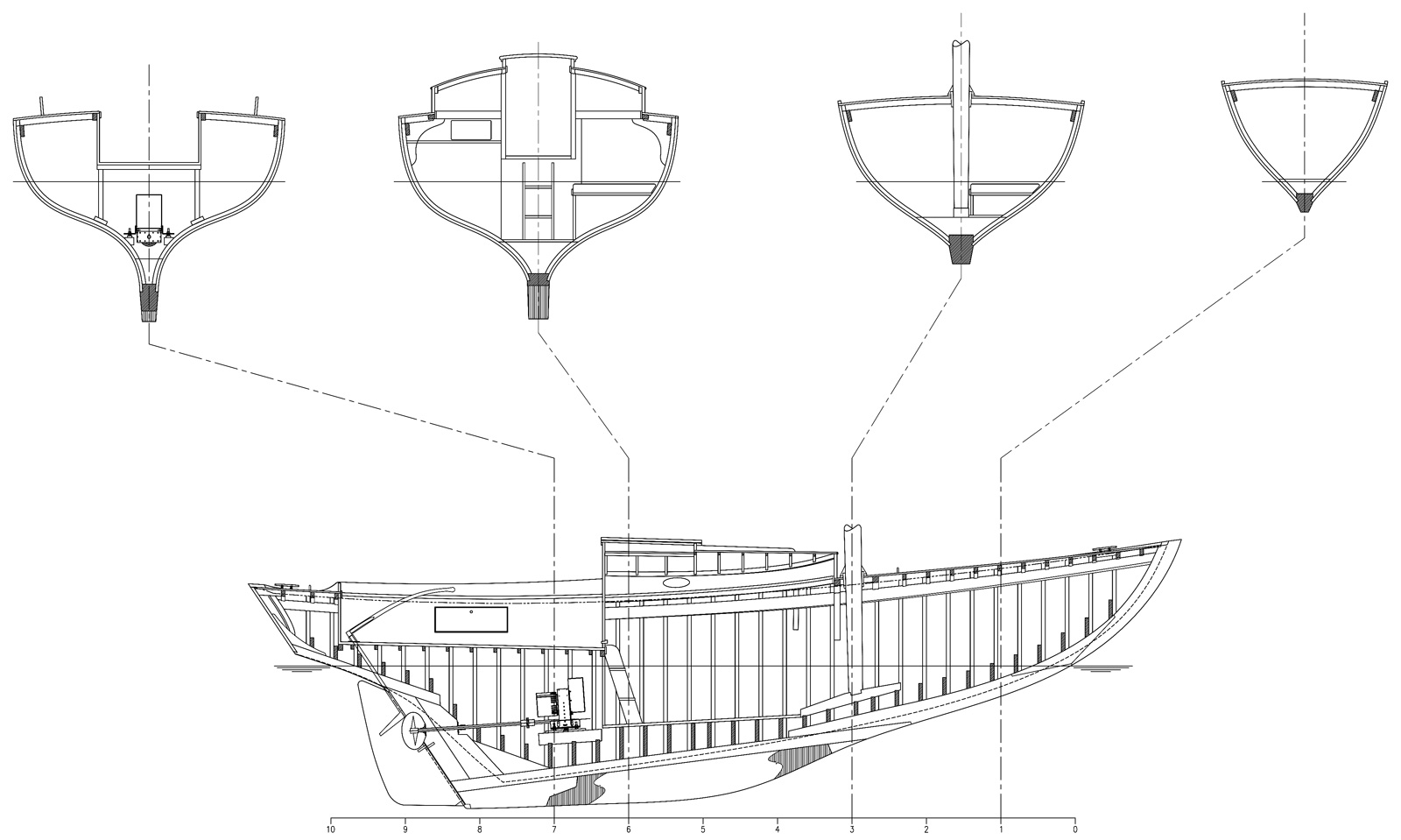

The body plan reveals sections that describe relatively firm bilges, which give Marta a fair amount of form stability. This, combined with a 40-percent ballast ratio, helps her stand up to a breeze and stay dry when punching into a head sea.
The well-proportioned gaff-headed mainsail suits Marta functionally and aesthetically. Its gaff is sufficiently peaked up to discourage it from sloughing off to leeward as we beat to windward. This desirable trait is enhanced by the gaff’s relatively short length and an efficient angle of pull for the peak halyard, which is permitted by a mast that extends well above the height of the gaff jaws.
As its name suggests, the self-tending jib cares for itself as we come about. The jib’s club, which is tacked down to a pivot on the foredeck, ensures that this 90-sq-ft sail automatically relaxes a little as the sheet is eased for sailing off the wind. As we sheet it in for working to windward, the jib will flatten itself slightly. This seems to be an improvement upon self-tending jibs with their clubs or booms tacked directly to headstays, as they sometimes set too flat when running or too full when sailing hard on the wind.
Marta’s standing rigging is simple. Sufficient drift to the shrouds eliminates any need for backstays.

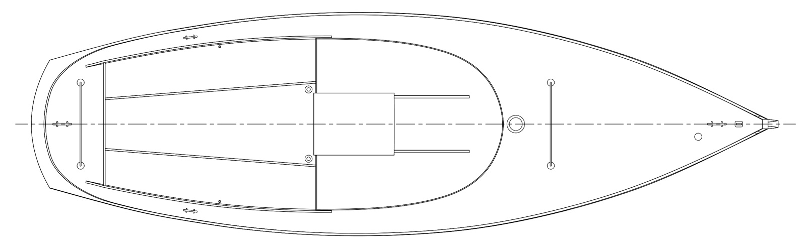

The crew sits at deck level with backs against gently curved coamings.
The crew sits at deck level with backs against gently curved coamings. This cockpit sole is well above the load waterline, for self-bailing.

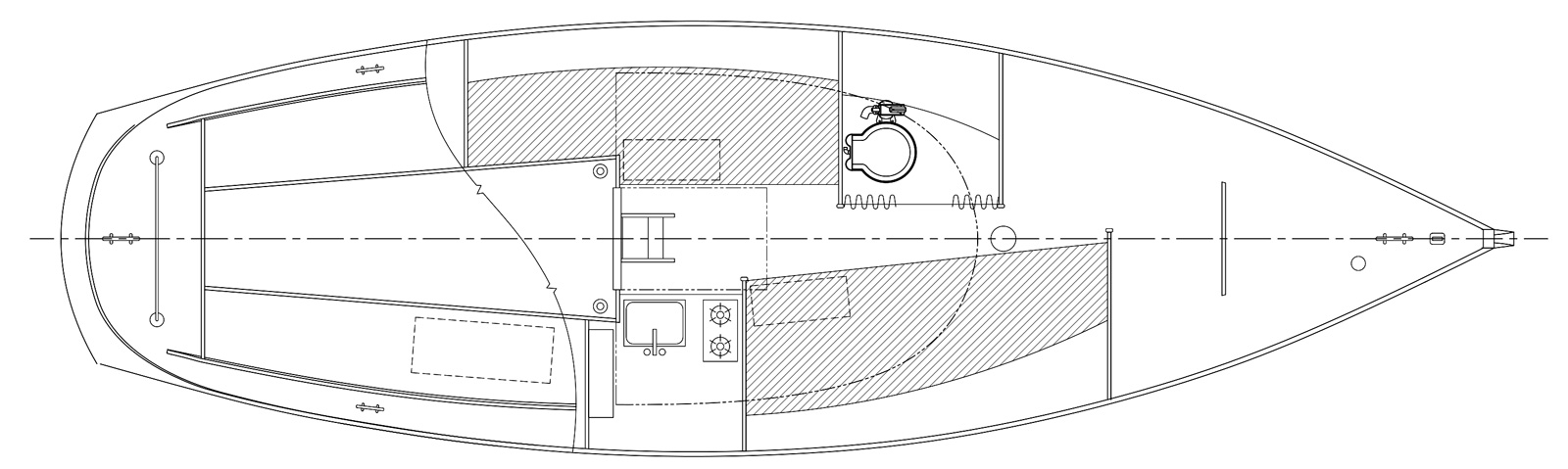

The cabin has two single berths and a galley counter.
The cabin has two single berths and a galley counter. The small head rests behind a curtain.
Marta’s cockpit sole rests well above the load waterline, which ensures reliable self-bailing. Her crew sits at deck level next to the gently curved coamings. This arrangement provides good visibility and comfort.
Down below we’ll find two full-sized single berths and a basic galley counter. The small head rests behind a curtain. Most sailors understand that true privacy doesn’t exist aboard boats of this size and type.
MARTA’s hull sections show relatively firm bilges.
MARTA’s hull is built plank-on-frame, which is Gannon & Benjamin’s specialty. The sections show relatively firm bilges, which give Marta a fair amount of form stability. The structural timbers of hull No. 1 are of purpleheart and live oak. Her first several bottom strakes and sheerstrake are of wana; the rest of the planking is cedar.
