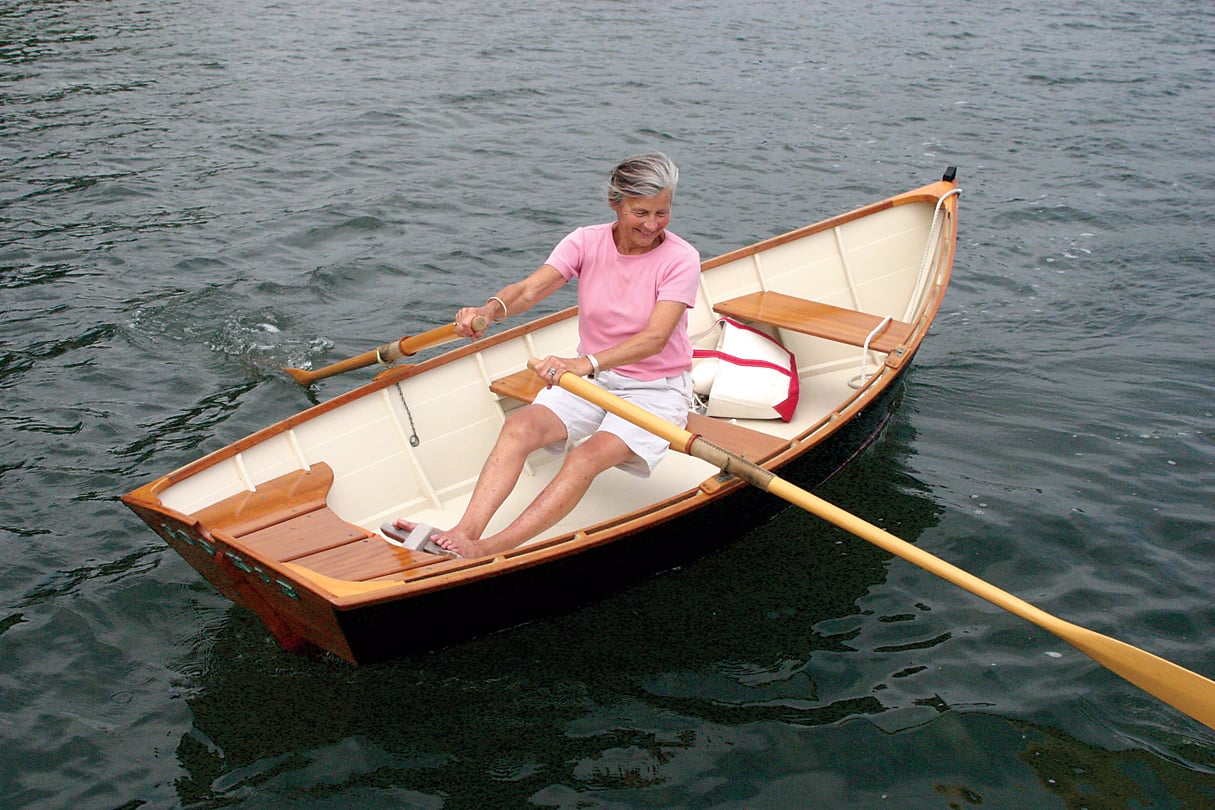

A flag-snapping breeze riffled the surface as my friend and I rowed around Pleasant Bay, near Chatham. In line with what I had noticed while looking at her plans over the years, the Asa Thomson skiff is high-bowed for a boat of such diminutive size. This gives her a jaunty sheer and plenty of freeboard amidships. While this perky little turned-up snout does cause her bow to blow off somewhat, it also provides an added sense of security. My guess is that she was originally designed for clamming, qua-hogging, and fishing around the New Bedford area. The wet-well, located under the ’midship seat, also indicates this use. High, secure-feeling sides and a flat bottom are good for this type of work. The wet-well, which adds strength to the boat, can instead be made to be a dry-well and, rather than stowing an afternoon’s catch, can be used to hold gear or a picnic lunch.
Trying to put my finger on what makes this design so special, I have been able to pick out a few of the wonderfully correct features (at least to my eye) that make this boat worth building. First, there is the profile of the bottom. The aft end of the bottom sweeps up to just clear the water for easy propulsion with oars or a very small outboard (no more than 3 hp, I’d say). This skiff rows so easily that I think very few would opt for the complications, cost, and smell of an outboard. COOKIE’s owner rows her exclusively. While the aft sweep clears the water, the straight, almost level bottom profile forward reduces pounding and helps to keep the bow from blowing off in a crosswind. This reminds me of what I have heard some old-timers say for achieving good tracking under oars: “Trim by the bow going upwind, and trim by the stern going downwind.”

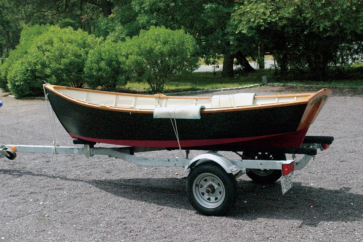

Traditionally built, the Asa Thomson skiff weighs 125–150 lbs. Plywood construction makes COOKIE, a lot lighter and renders her immediately usable upon launching since there’s no waiting for wood to swell. She is trailerable and is easily lifted and launched by two people.
While I believe that remaining faithful to the scantlings will produce the best results, there is one major modification that I would recommend: building the bottom with marine-grade plywood, say, 3⁄8″ thick. Using plywood will ensure a water-tight bottom despite long periods ashore. Asa Thomson’s original, double-planked bottom with muslin between the layers will also be watertight, but it weighs considerably more than the plywood alternative, which is about 40 percent lighter. Asa Thomson designed and built his original skiff before high-quality marine plywood was readily available. As smart as he was, I have to believe that if he were with us today, he might consider this alternative, too. Pease Boatworks gave COOKIE plywood sides as well as a plywood bottom. One of their driving factors was that the garboard strake is so wide that finding natural wood (at least 14″ wide) was difficult and prohibitively expensive. For them, plywood seemed the logical choice.

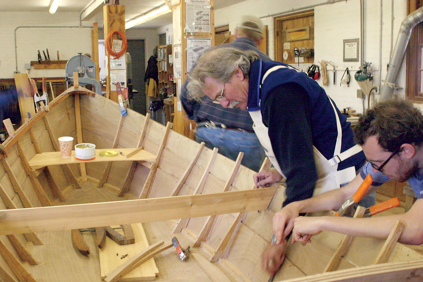

Students at WoodenBoat School learn traditional building techniques in a class taught by John Karbott. The Asa Thomson skiff’s simplicity, lapstrake planking, and sawn frames make it an excellent project for the first-time boatbuilder.

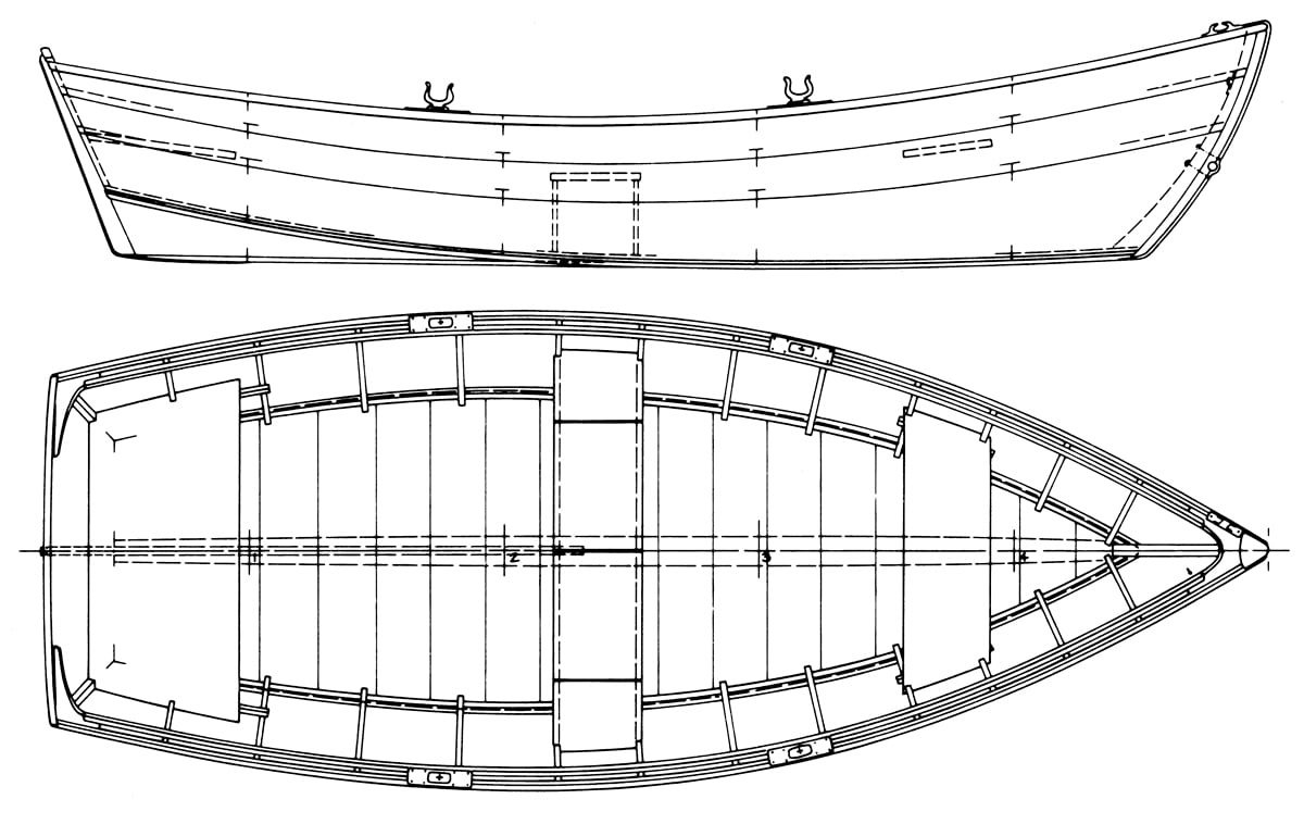

The profile view shows harmony among the stem, sheer, and transom. The plan view (bottom) gives a good indication of the boat’s flare, which contributes to its roominess and stability.
