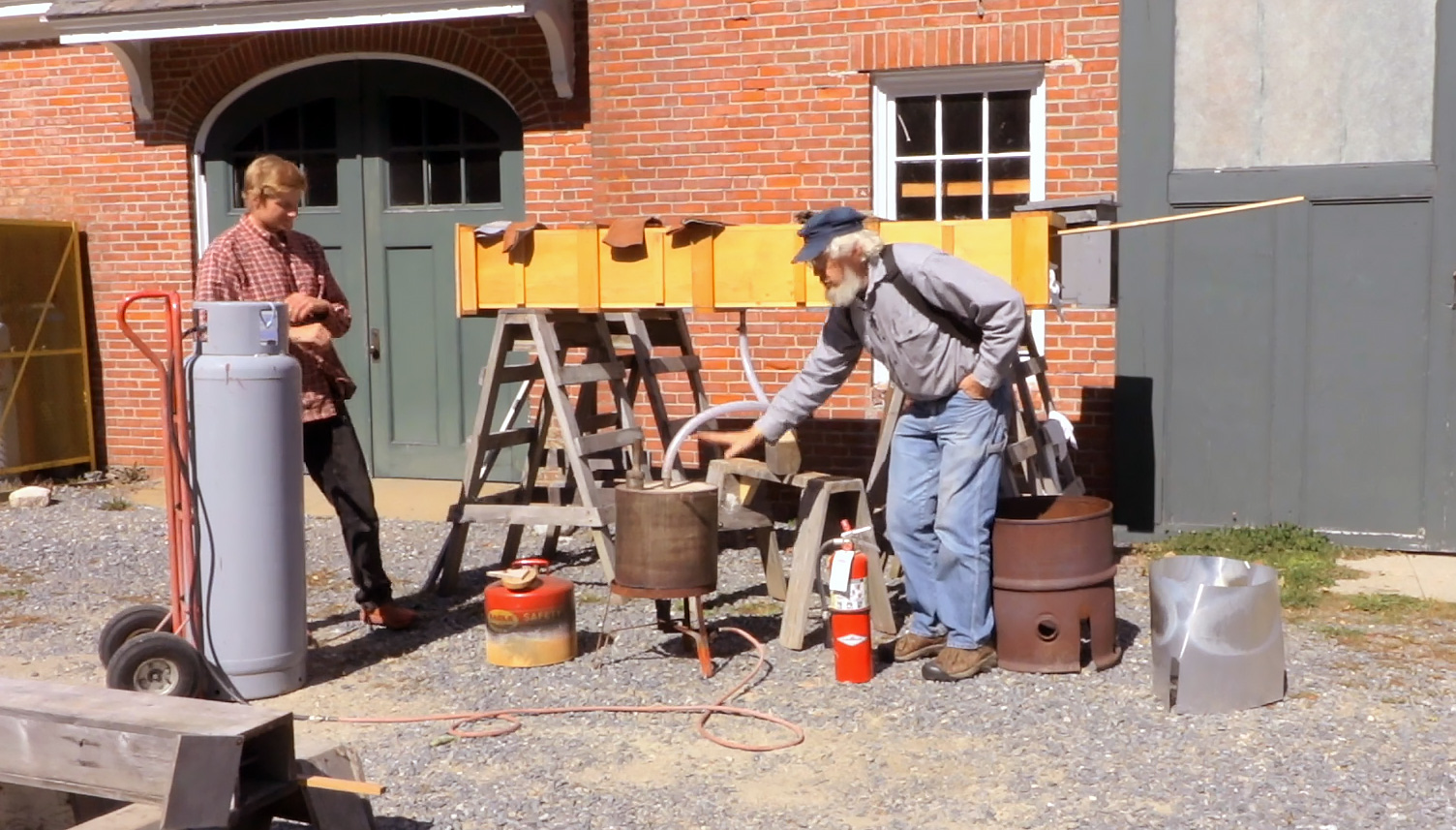

In a subsequent email, Harry wrote, “As a teacher, you must have recollections of a few embarrassing moments in front of a class. I certainly have a few of these. One was at WoodenBoat School: Our class was about to bend some knees, and the director asked if I would mind demonstrating in front of all three classes in session. Also in attendance was a visiting boatbuilder whom I had met in Tasmania. I stationed myself at the jig and called for the hot piece of oak, which came in a dramatic sprint from the steambox. I clamped it in place and gave it all I had. The piece did not bend even ¹⁄₁₆″. The piece brought to me was kiln-dried. It could have been solid steel, for all that it bent. The oak cooled as my ears heated up. My feeling is that when a piece of wood is put in the steambox, particularly if it has any size, there is little penetration of moisture into the wood, steaming being a way to heat the wood with no loss of the moisture already within the piece being bent.”
I have had my own classroom moments of chagrin, but none as dramatic as Harry’s. He is correct in surmising that steam in a steambox does not add moisture to the wood—as I noted in my column in WB No. 304. What I didn’t emphasize in that column was the general futility in trying to bend kiln-dried lumber. At best, if the wood has been very carefully kiln-dried on a slow schedule, you would still need to soak the wood for an extended period of time to condition it to a moisture content of 15 to 20 percent. At worst, no amount of soaking will soften kiln-dried lumber that has been hurried through a fast-drying schedule at higher-than-recommended temperatures—a common practice with construction-grade lumber. Under those conditions, the wood will be partially torrefied—a process I described in WB No. 304—making it extremely resistant to bending.
