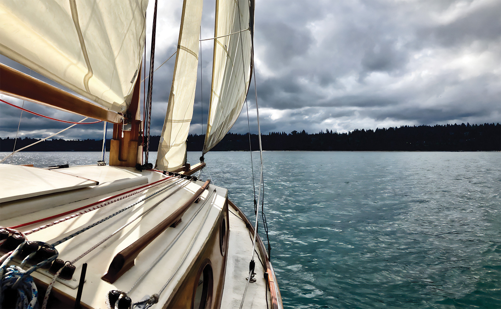

On the author’s 21’ cutter, all lines now lead to the cockpit.Lawrence W. Cheek

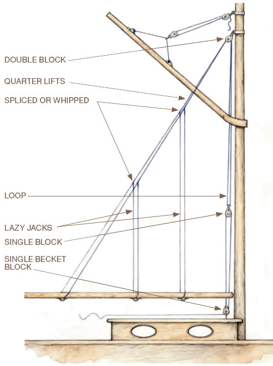

Arnt Arntzen’s method of combining lazyjacks with the quarter lifts of a gaff rig’s boom.Isaac Robbins
The author admired Arnt Arntzen’s method of combining lazyjacks with the quarter lifts of a gaff rig’s boom.

I had led nearly all the lines to the cockpit when I built the boat; the only reason anyone normally had to leave the cockpit for sail handling was to pull down the staysail. Creating a remote downhaul—a line running along a toerail to the cockpit—was an easy 90-minute fix. I also remembered that once or twice every year the jib’s roller-furler had jammed, and I’d had to go forward, lie flat on the bowsprit, and manually wrench the furling drum into action. Studying the geometry of the furling line’s run to a block on the bowsprit, I could see that moving the block farther forward would reduce friction and probably solve the problem. Again, easy.

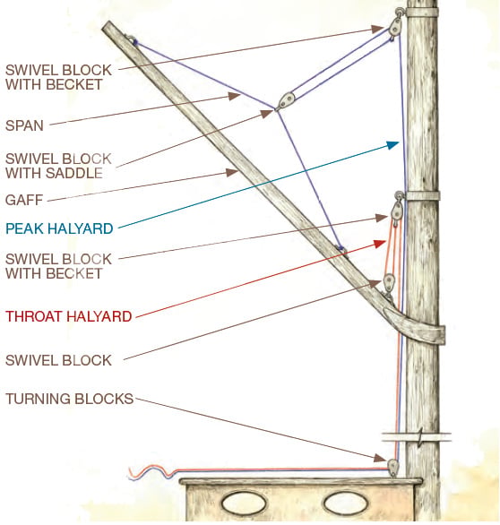

A 2:1 purchase for the gaff’s throat and peak halyards.Isaac Robbins
A 2:1 purchase for the gaff’s throat and peak halyards, as recommended by sailmaker Sean Rankins, vastly eases the effort required to raise the sail.
A more complicated, and much more expensive, suggestion came via Sean Rankins of Northwest Sails & Canvas, who had made PATTY B’s sails. He advised rerigging all halyards for a 2:1 purchase to make it not only easier to hoist the sails but also to provide much better luff tension. I was dubious about any need for rerigging the pipsqueak jib and staysail, 67 and 49 sq ft respectively. But I’ve learned to trust Sean’s advice, and he was right. New lines and blocks set me back more than $400, and the mainsail throat and peak halyards are now crazy long at over 70′, but our pleasure in seeing perfectly set sails is palpable. And it’s half the effort to get them there.

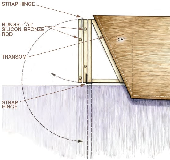

PATTY B, the author’s Sam Devlin–designed Song Wren 21.Isaac Robbins
PATTY B, the author’s Sam Devlin–designed Song Wren 21, has a transom that rakes 25 degrees, calling for the custom boarding ladder he’s shown building in the photo above.
PATTY B’s transom rakes at 25 degrees, so there’s not much room on it to mount a production-model reboarding ladder. Since 2019, we’ve carried a folding ladder in a cockpit locker to be deployed from a cleat if ever needed for a rescue. It’s a clumsy operation, and I’ve known that if I were the unlucky man overboard, I would be having to talk someone still aboard through the process—and I sometimes take friends out who have little boating experience. It’s far better, obviously, to have a folding ladder permanently mounted to the transom, operable either by the swimmer or crew in the cockpit. Why, I wondered, am I feeling limited by the manufactured choices? I could build a ladder tailored to this boat. It’s turned into a complicated undertaking, involving first making a working full-sized model with scrap wood and cheap hardware, and it’s still in progress. But it will be ready for the 2026 season.

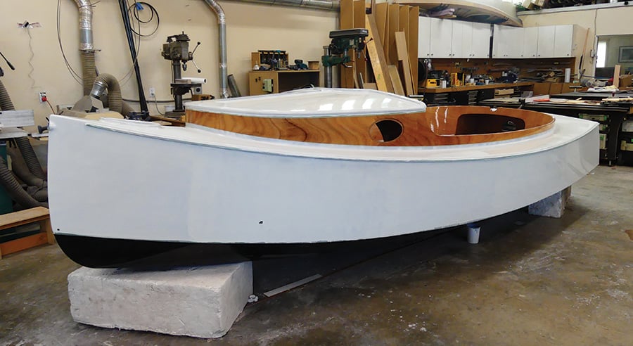

Old Salt—a design with old salts in mind
“What if we designed a boat, and at every design decision we chose to look out for the older sailor?”
Sometimes such rhetorical questions bloom into missions, which this one did. It launched five years of discussion and back-and-forth drawings between Joshua Colvin and Brandon Davis, finally materializing into a stitch-and-glue plywood catboat kit intended for production in spring 2026. Josh, the publisher of the online magazine Small Craft Advisor, earlier collaborated with the New Zealand designer John Welsford to create the 12′ SCAMP. Brandon is the owner of Turn Point Design, a Port Townsend design and CNC-cutting firm specializing in marine fabrication.
The Old Salt concept began with typical catboat proportioning of a 2:1 length-to-beam ratio: 15′3″ × 7′6″. The cockpit is deep, wide, and uncluttered, with the centerboard trunk offset into the starboard seat riser. The boat weighs about 450 lbs, with provision for an equal weight of water ballast in the bilge. It’s apparent that it aims to emulate the stability of a much larger boat; the designers expect Old Salt sailors are unlikely to be eager to practice capsize-and-recovery drills. “SCAMP is amazingly seaworthy for a 12′ dinghy, but it’s still a 12′ dinghy, and if you make a big mistake you’re going to go for a swim,” Josh says. “The Old Salt is going to be a boat where if you make a mistake, lose your balance and slip to the lee side or something, you’re not going to go over.”

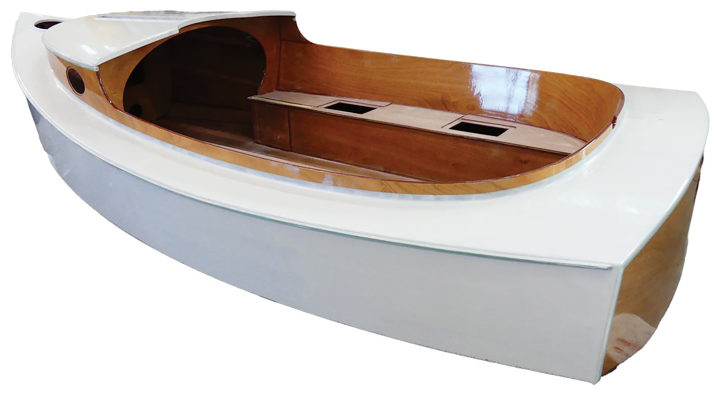

Old Salt, a design aimed at aging sailors.Lawrence W. Cheek
Stability, ergonomics, and safety are at the heart of Old Salt, a design collaboration between Joshua Colvin and Brandon Davis aimed at aging sailors.
The rig might prompt sighs of covetous envy from anyone who’s spent a tedious launching-ramp hour rigging a small sloop or yawl. There’s a 20′ carbon-fiber mast in two fit-together sections that store in the boat and a flat-top, battened sail. There are no stays, and a heavy batten in the sail’s foot functions as sort of a boom without the hazard of hard timber swinging overhead. The mast weighs less than 15 lbs, and to make stepping as easy as possible, there’s a 34″ long “toaster slot” in the cuddy cabintop. Pop the mast in at a slant, rotate it to vertical, close a hinged door and pin the mast in, and you’re ready for the sail. The boat is designed for the crew to never leave the cockpit, and a quarter-round cutout is sawn into the cabintop to support someone working at the mast.
Tradeoffs eternally haunt boat designers: make one performance aspect better, and another one becomes worse. In Old Salt’s case, the very broad beam and embracing cockpit enclosure erase any possibility of rowing, although two paddlers could nudge it along for short distances. The designers are working with EP Carry, a Seattle-area electric outboard manufacturer, on a motor specifically tailored to fit. Josh says other electric outboards or a small gasoline outboard also would work. But any kind of motor adds expense and potential complications that oars wouldn’t.

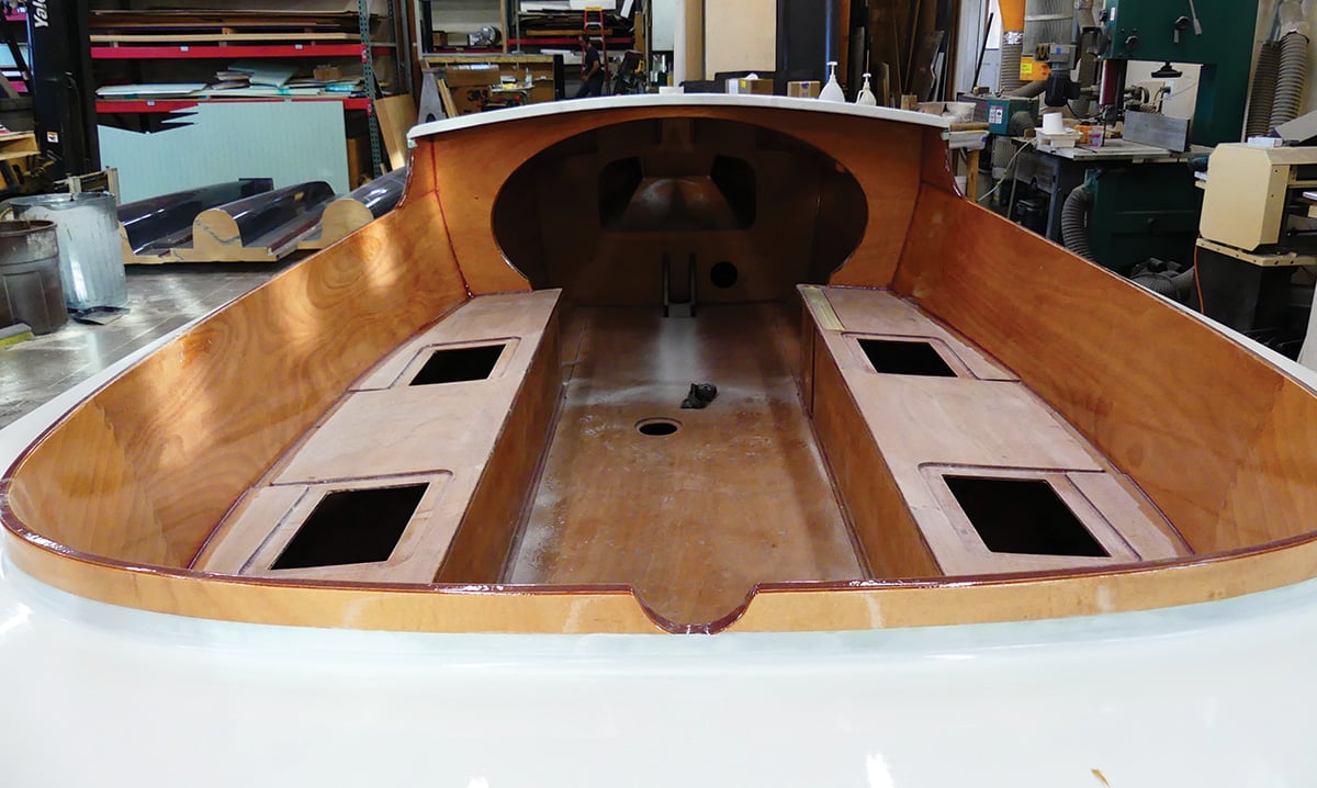

The boat is also designed to be forgiving.Lawrence W. Cheek
The boat is also designed to be forgiving; the crew should never have to leave the cockpit.
