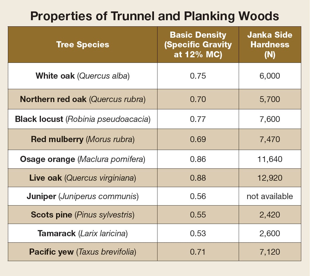

In my 2012 column on trunnels, I didn’t address the issue of matching wood properties between trunnel and plank or frame. The most critical features are relative wood densities, as measured by specific gravity, and side-crushing strength, as measured by compression parallel to grain. If the trunnel is much denser than the timber, splitting, or at least deformation, can occur. If the trunnel is much less dense than the timber, it will provide little fastening strength and may loosen with time.
The simplest solution is to use the same wood for trunnel and plank or frame, as recommended by William Douglas above. This works well if the wood has high decay resistance, as in the case of white oak, live oak, or longleaf pine. But where planking is not decay-resistant, a more durable trunnel is preferable since the exposed end-grain provides an ideal entry point for decay fungi, hence the widespread use in the past of highly decay-resistant woods such as black locust, red mulberry, and Osage orange.
In the table above, I have provided values for some trunnel and planking woods based on specific gravity and a Janka side hardness test, a measure, named after its creator, Gabriel Janka, for the force required to push an 11.28mm steel ball half of its diameter into a piece of wood. I had wanted to use compression perpendicular to the grain values, but was unable to get this measure for some of the woods, so have used side hardness as a rough proxy. For white-oak or red-oak planking, black locust is a reasonable density match but because of its higher hardness, the trunnel diameter needs to closely match the bore hole size. Red mulberry is a closer match with white and red oaks, while black locust is a good hardness match with live oak.
In Norway, common juniper (Juniperus communis) is often used as a trunnel wood when planking with Scots pine (Pinus sylvestris). Both woods have similar densities. Juniperus communis also grows in North America and could be used as trunnel wood with red pine (Pinus resinosa), which has properties nearly identical to Scots pine. Tamarack has properties similar to juniper and, as noted by Walt, has been used in Canadian shipbuilding, although it is somewhat less decay-resistant than juniper. U.S. West Coast builders could use Pacific yew as a reasonable substitute for black locust.
