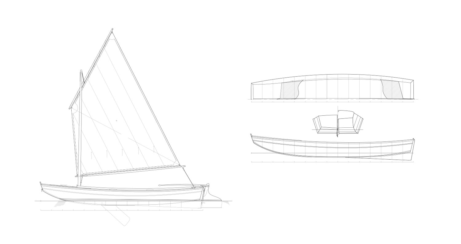

Line drawings for the Swan Point Garvey boat.Doug Hylan
Traditional garveys were sprit-rigged, but Russ chose lug rig for its ease of handling and quick striking. The dismantled rig fits easily inside the boat. The scow shape of the garvey hull carries nearly its full beam all the way forward and aft, creating more stability and space than a conventional hull. The slight V sections forward and aft ease the quarters to improve sailing performance.

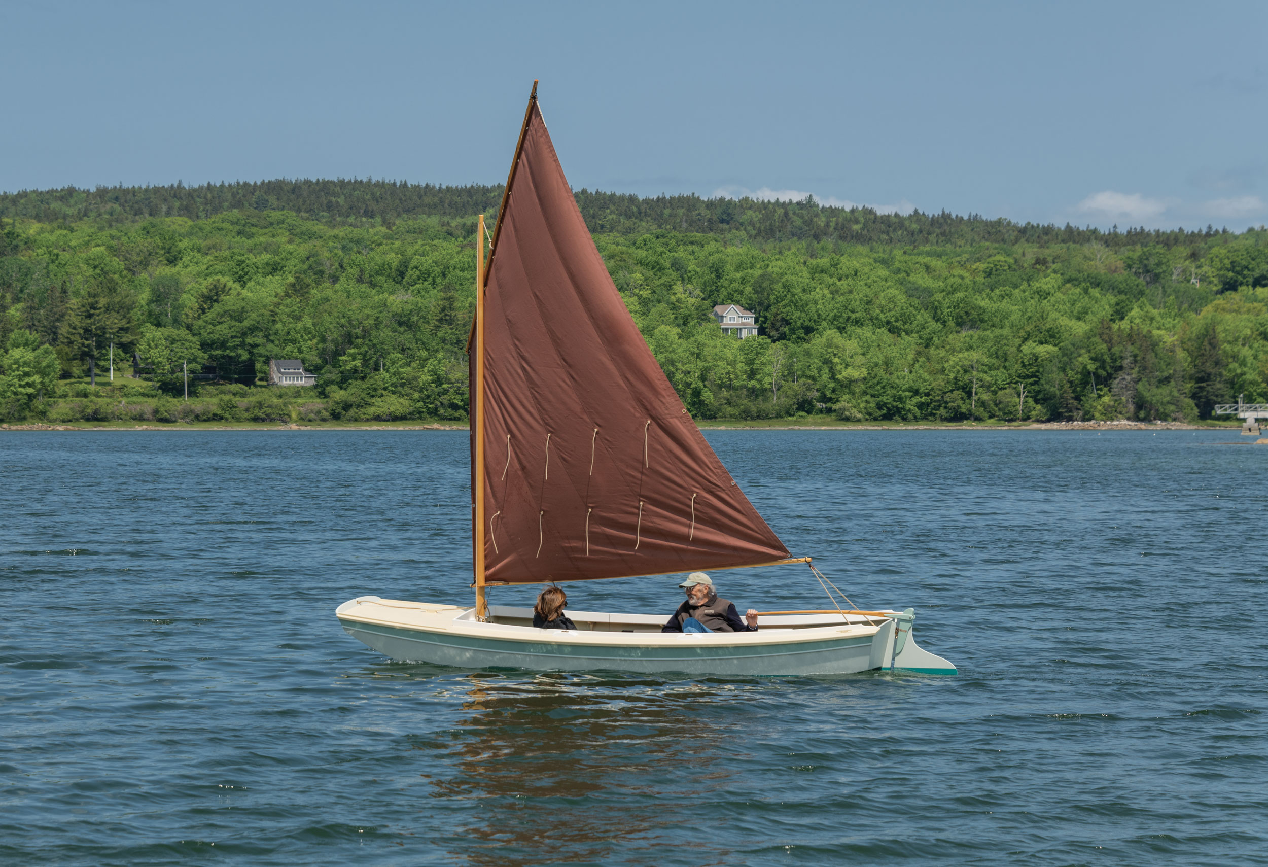

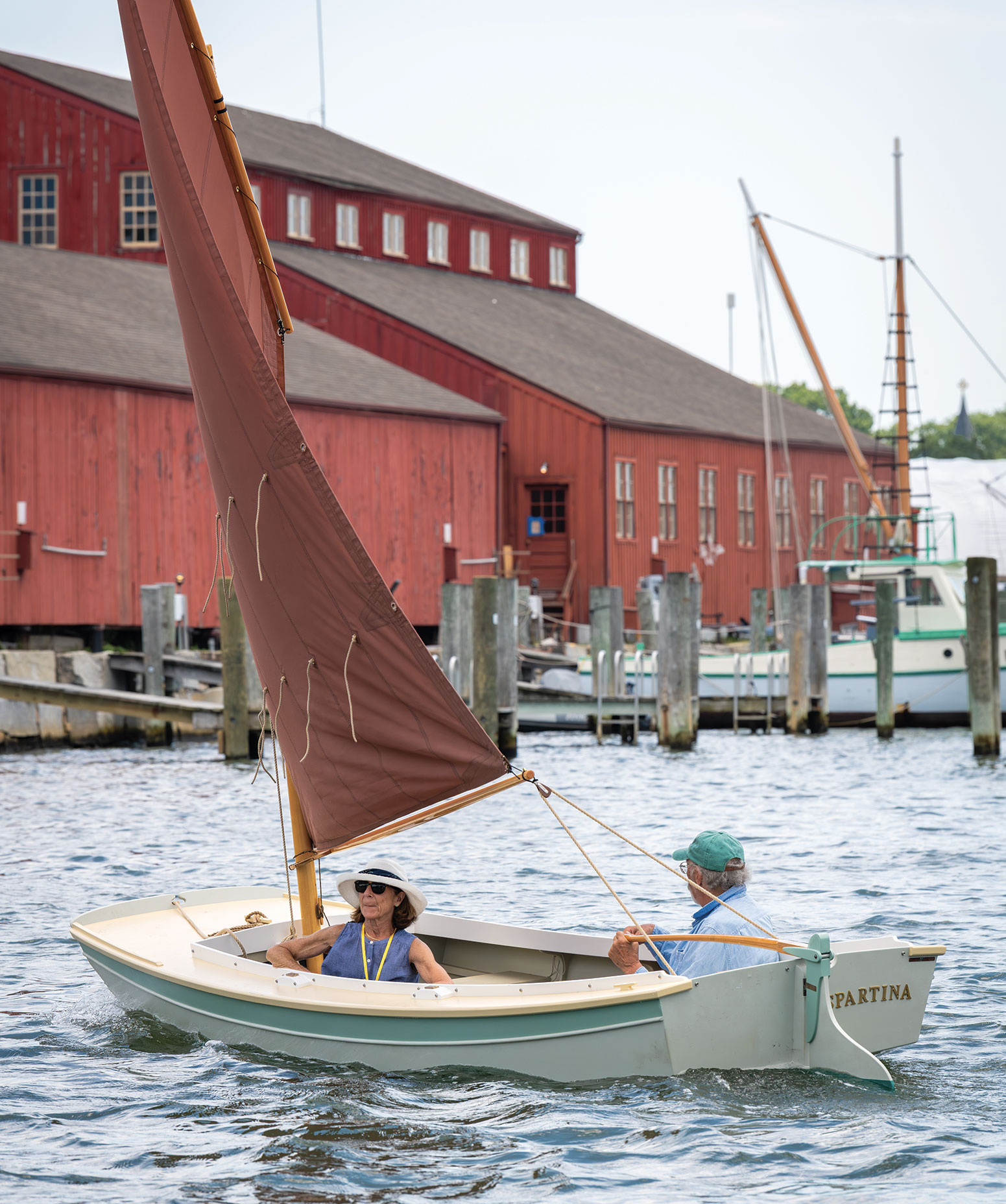

Man and woman aboard a small boat with red sail named SPARTINA.Tyler Fields
SPARTINA, as the first boat of the Swan Point Garvey design is called, sails at Mystic Seaport during the 2025 WoodenBoat Show.

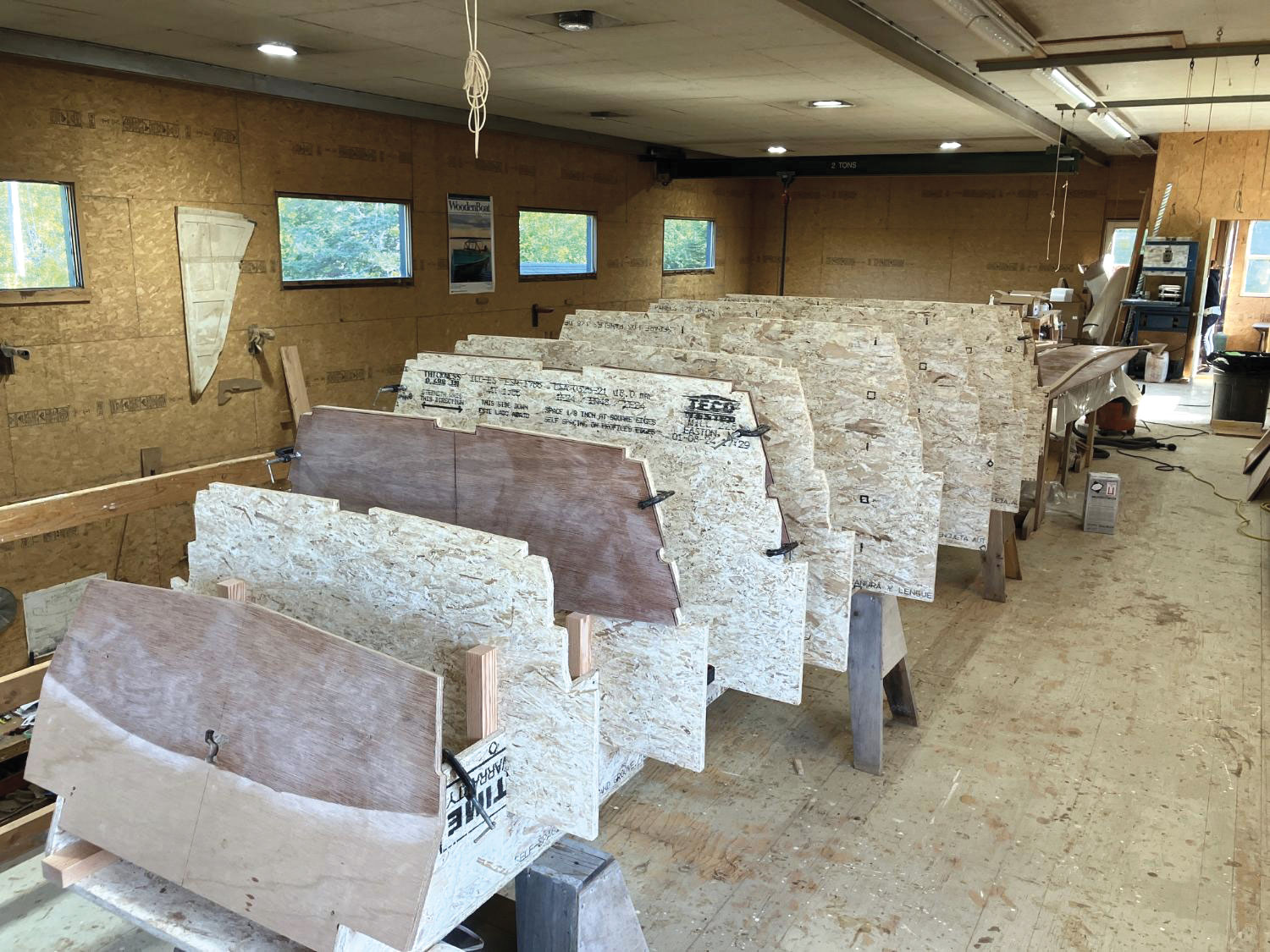

Wooden boat molds.Hylan & Brown
Construction began with a set of CNC-cut molds, the two transoms, and two bulkheads.

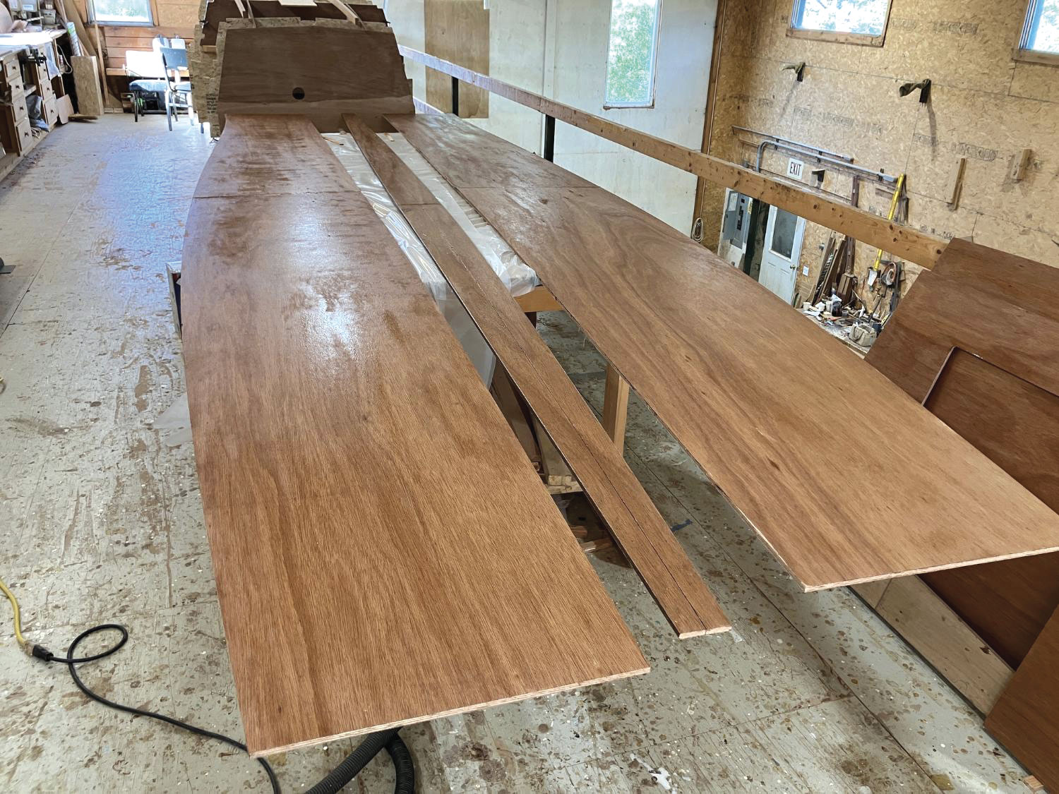

Plywood panels.Hylan & Brown
Plywood panels were epoxy-coated before being hung.
Boat hull panels glued in place with epoxy and fastened with bronze screws.Hylan & Brown
The meranti hull panels were glued in place with epoxy and fastened with bronze screws where needed.

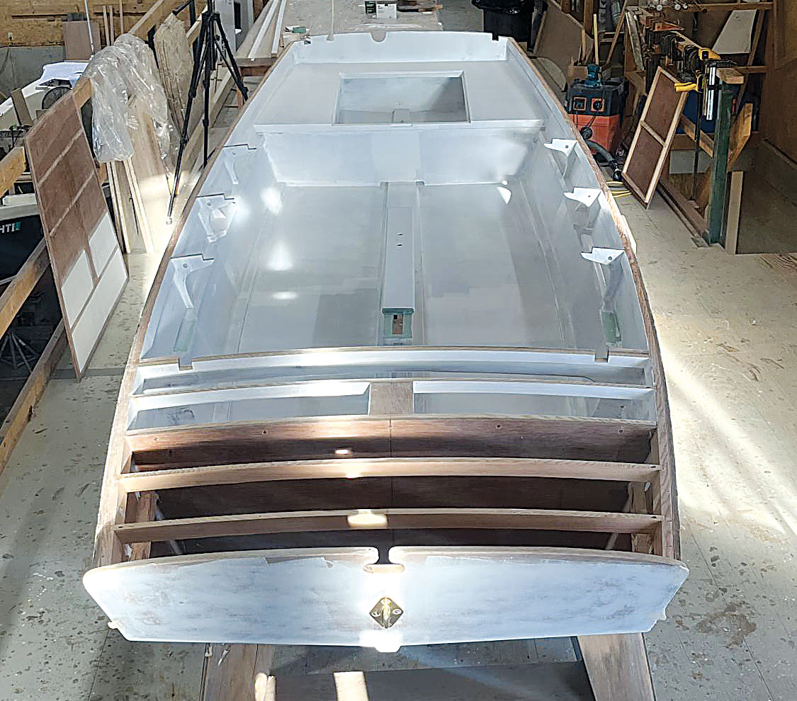

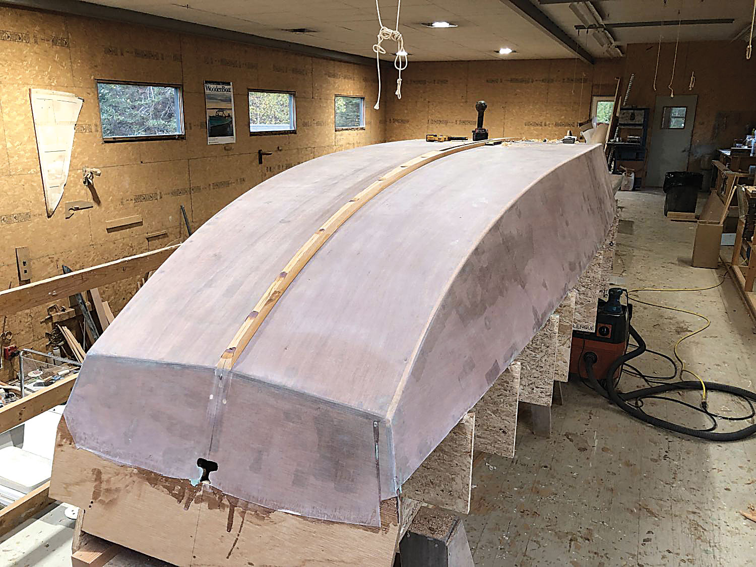

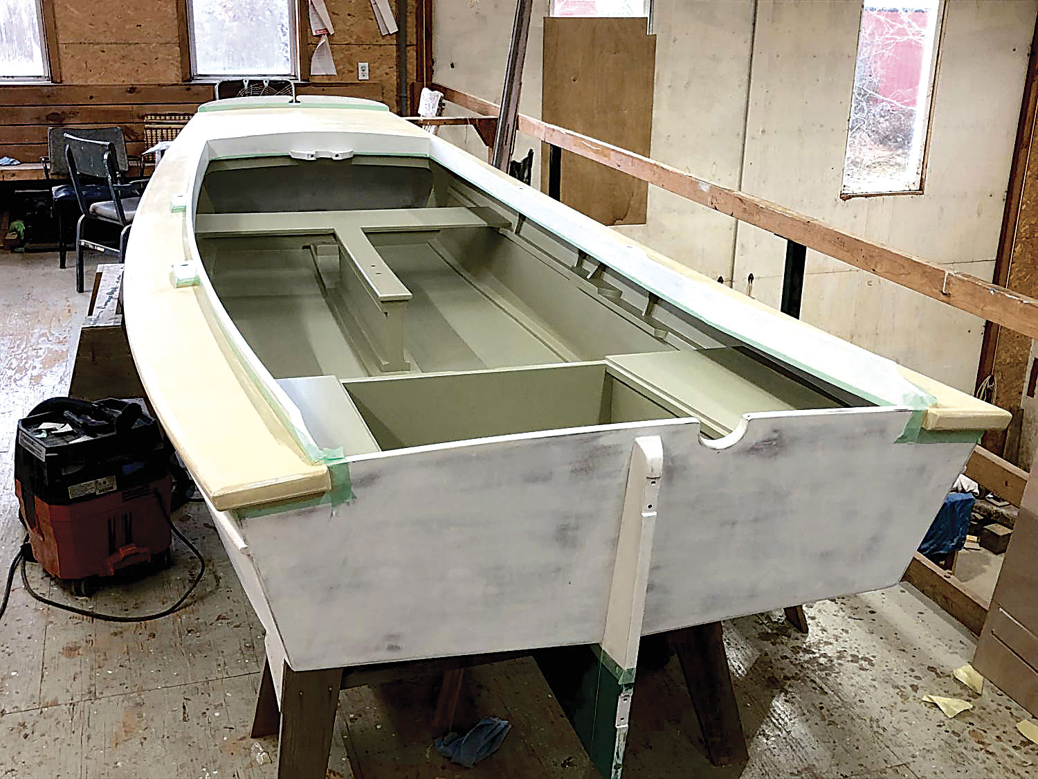

Small wooden boat under construction showing all the surfaces.Hylan & Brown
All of the boat’s surfaces, save for the tiller and spars, are painted in a traditional low-gloss scheme. Visible here, too, are the hull’s dimensional Douglas-fir chines, clamps, and framing.

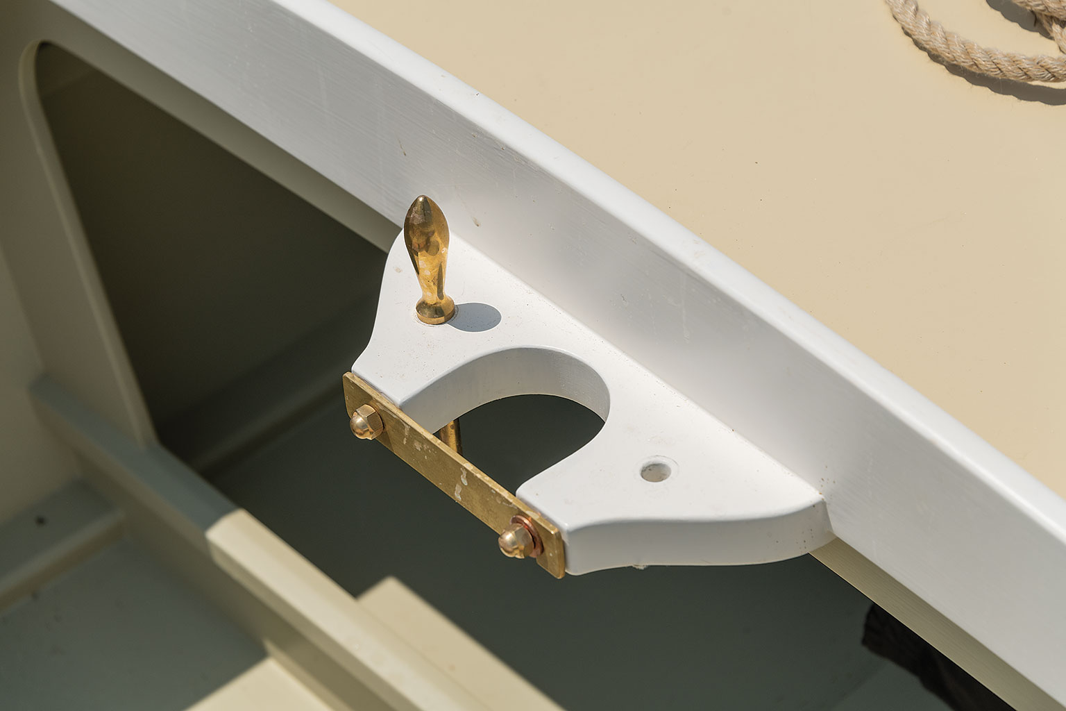

Mast gate aboard the Swan Point Garvey.Benjamin Mendlowitz
A mast gate allows the rig to be easily stepped at the launching ramp.

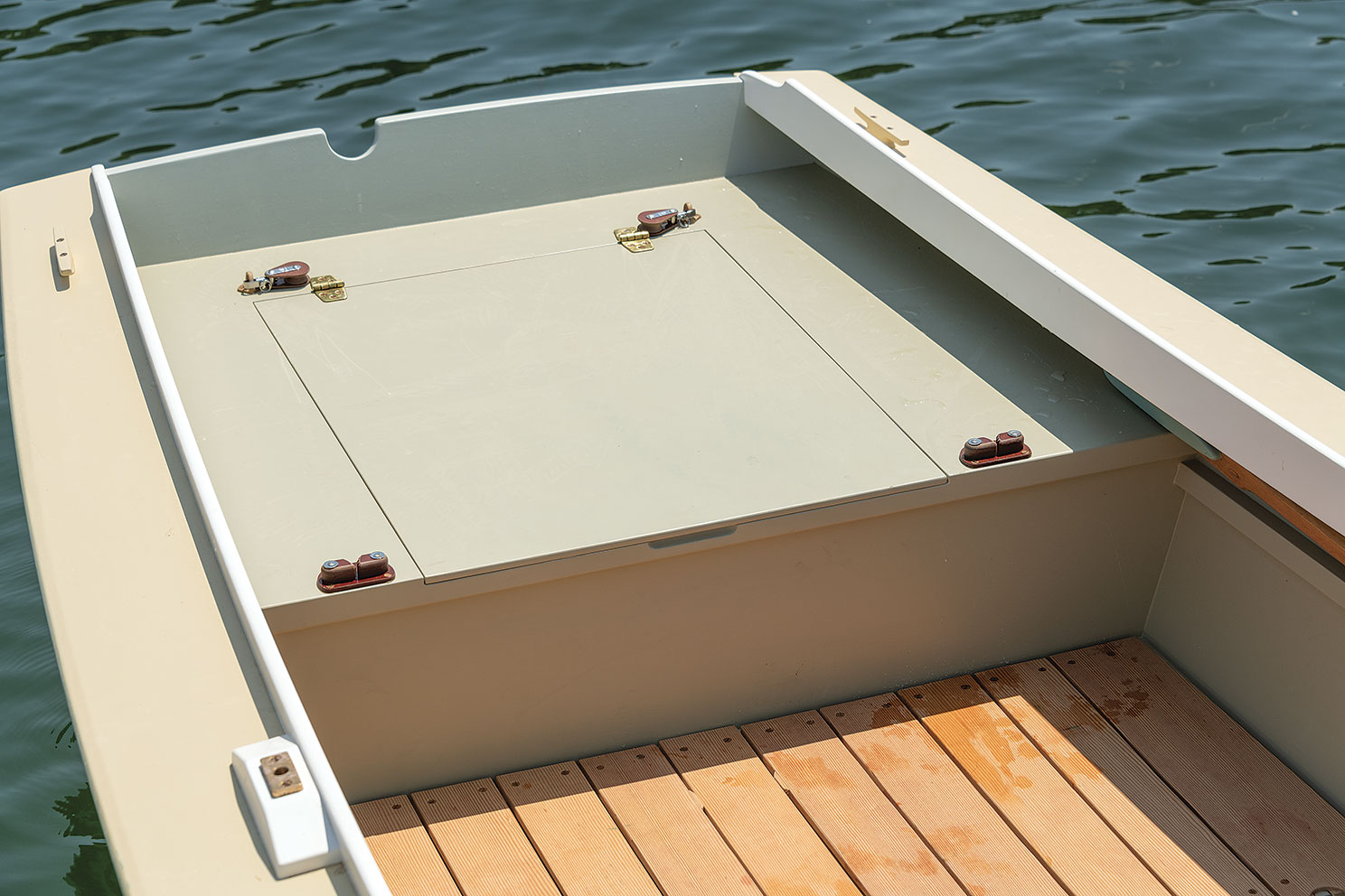

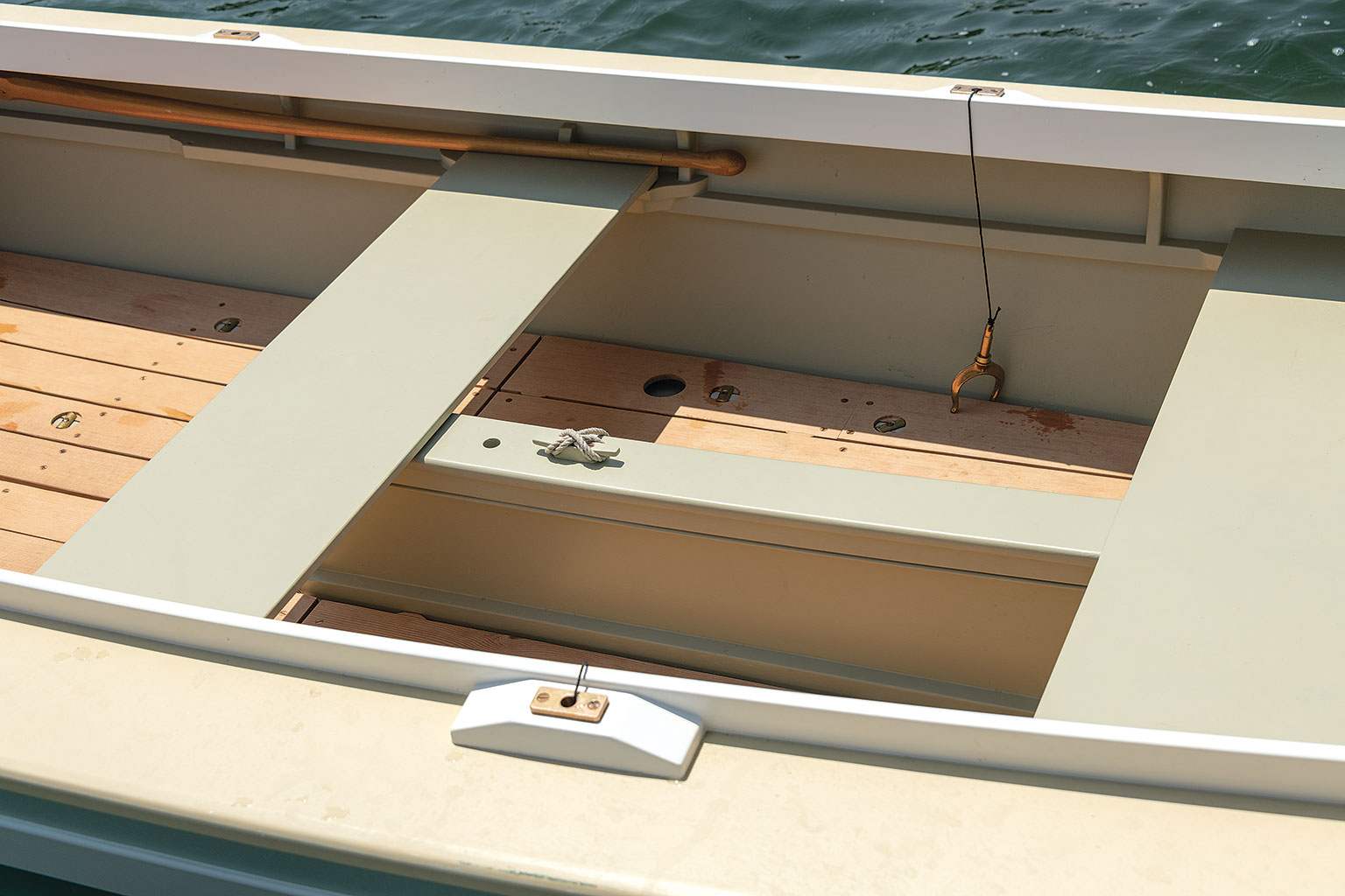

Swan Point Garvey afterdeck.Benjamin Mendlowitz
The afterdeck functions as a seat and has locker space between flotation chambers.

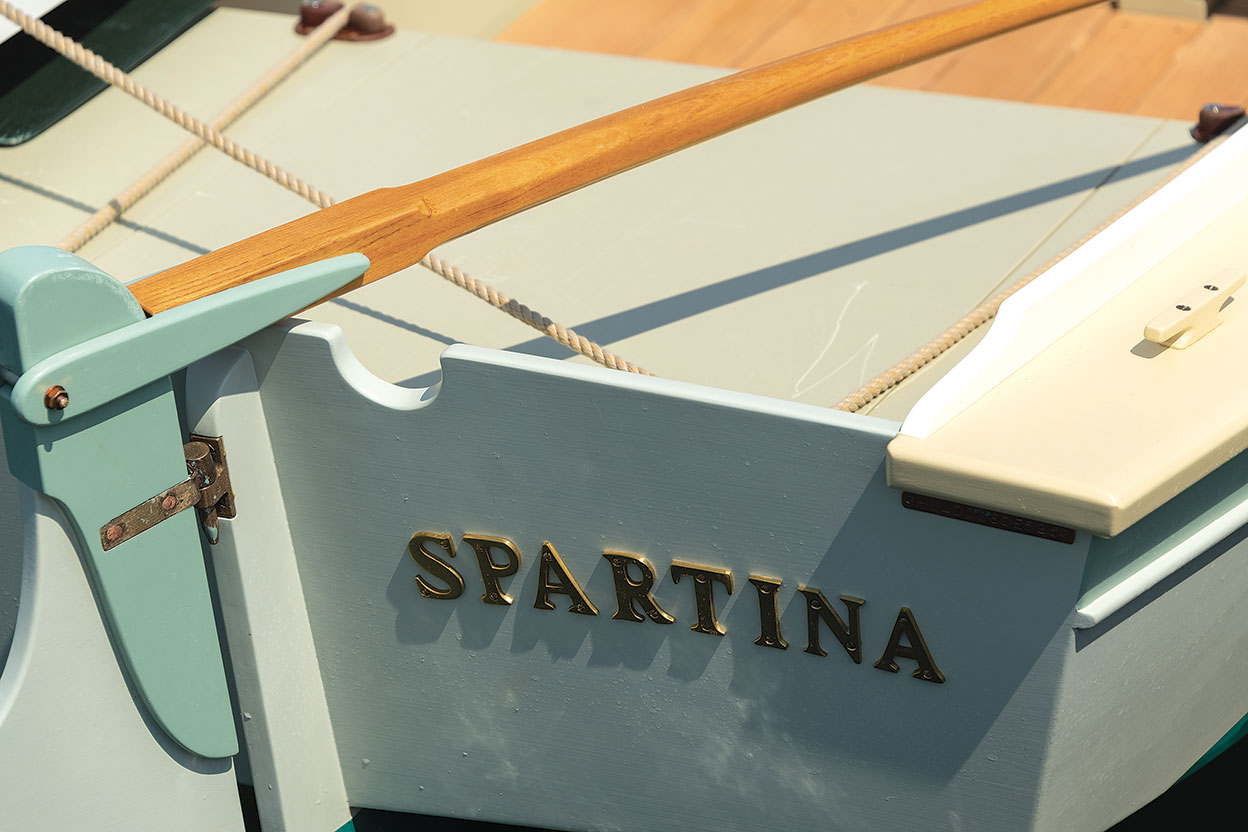

Rudder of a wooden boat named SPARTINA.Benjamin Mendlowitz
The boat’s shallow-draft rudder; options for sculling, rowing, and poling; and great form stability all suggest an ideal craft for marsh exploration.

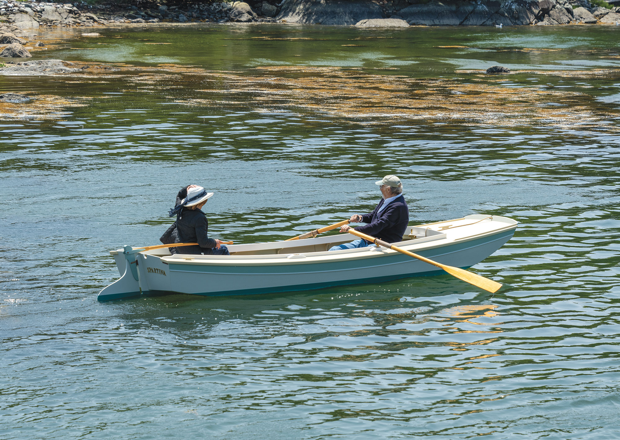

Man wearing a ballcap and woman wearing a white sunhat row a Swan Point Garvey.Benjamin Mendlowitz
Whether under oars or sail, the Swan Point Garvey can fill a variety of purposes. Since her launching, SPARTINA, the first boat of the design, has also been fitted with an ePropulsion 500W, 1.5-hp electric outboard motor.
