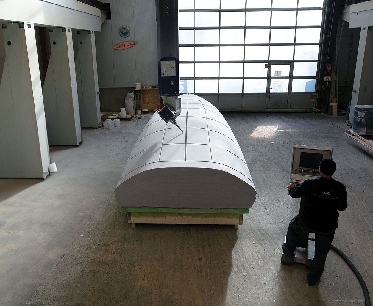

Eva BiederbeckA high-tech upside-down building jig for all future WOY 26 hulls has been milled by Knierim Yachtbau in Kiel, Germany, and a second jig was made for the deck. The precise and smooth surfaces make the jigs ideal for perfectly shaped laminations.

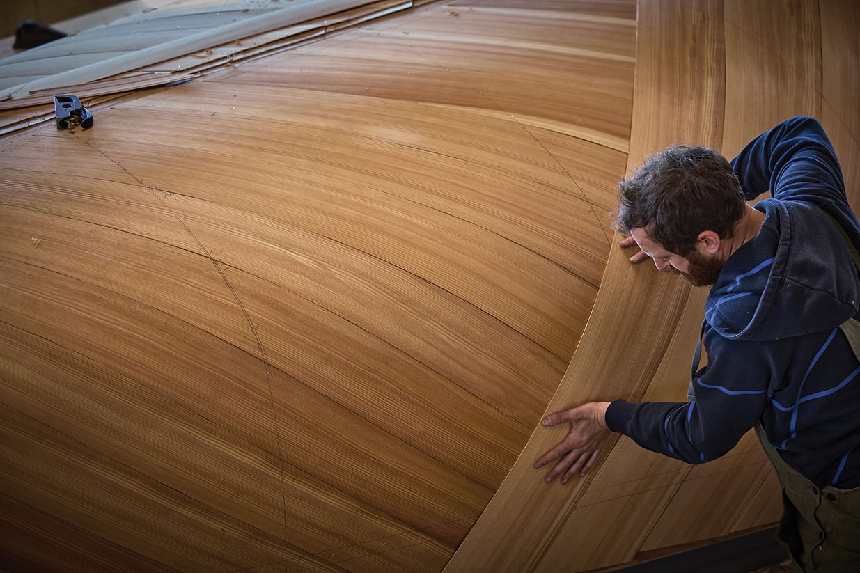

Eva BiederbeckThe third layer of 2.5mm-thick (³⁄₃₂″) larch planking veneers, set on the opposite diagonal to the previous layer, are stapled into place for hull No. 2. The innermost and outermost layers were placed longitudinally.

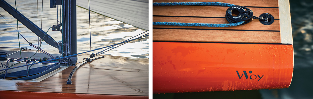

As the result of the encounter of these two visionary men, the WOY 26 is a very straight-ahead daysailer in every respect. The curve of the topsides transitions to the sprung-plank deck without a separate covering board. A wave-piercing AC75-style bow with ample tumblehome leads into a fixed bowsprit. Forward, the deck rises slightly to the forestay fitting to reduce turbulence in the airflow to the jib, as Martin explained. With its comparatively flat bottom sections and its high-set waterline, WOY appears to be hovering over the water rather than sitting in it.
With the hydraulic lifting keel fully extended for maximum stability, the boat’s draft is 1.9m (6′2½″). Lifting keels typically must be fixed in the lowest or highest position, but Menzer’s design calls for a guiderail allowing it to be set at various depths. The keel lifts through a slot in the deck’s kingplank; with the keel fully retracted for transport by land, the draft is reduced to 1.1m (3′7″). Together with the boat’s twin rudders—which have less draft than would be necessary for a single rudder—WOY is designed to operate in shallow lakes or marinas.
Leanness was also a driving force in the design goals for Jan and Martin: A single winch allows line-handling amidships at the forward end of the cockpit between two closable hatches; the jib is self-tending; the carbon-fiber mast is secured by rod-rigging shrouds held in swept-back spreaders, which eliminate the need for backstays.

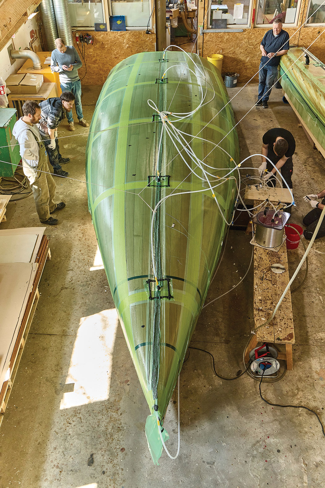

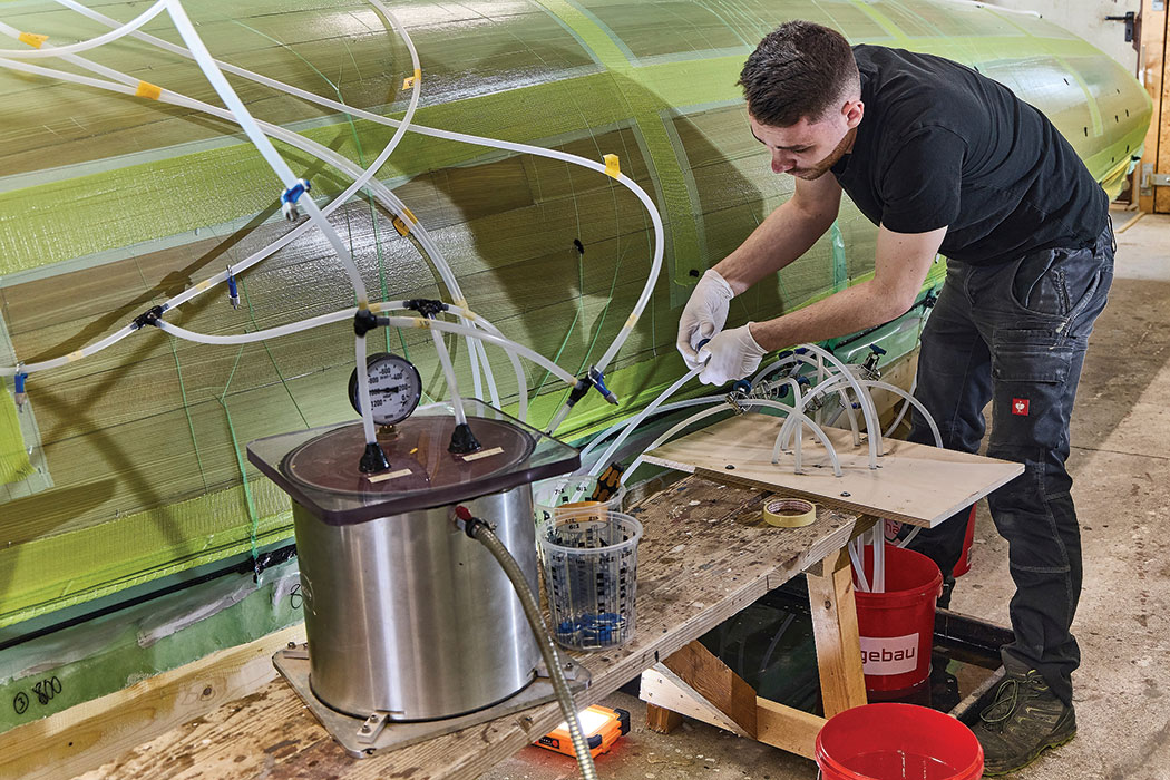

Nico KraussIn the setup for the patent-pending full wooden-hull vacuum infusion process, the hull is partially covered by a mesh for additional pressure and fully covered by a green translucent film. The tubes fitted along the keel line draw epoxy resin upward, bonding all four layers simultaneously.
Nico KraussThe red bucket holds low-viscosity infusion epoxy.
Nico KraussEight tubes lead from the bucket to four entry points on each side, set slightly below the edge of the veneers. The vacuum pump on the worktable draws resin through the hull veneer layers and the excess flows into a so-called “epoxy trap” bucket.
While working with Martin on the WOY design, Jan was also striving for something greater: nothing less than reinventing his process for building wooden boats. The WOY 26 hull No. 1 was built in a basic cold-molding process over a wooden jig, using spruce and pine veneers. The first layer was, however, made of thin wooden strips bent over the jig and fastened temporarily. In contrast, hull No. 2, which will be sailed on Lake Wannsee in Berlin, was built over a more elaborate jig and glued with a full-fledged vacuum-infusion process. Like vacuum-bagging, this process involves using vacuum pressure to hold the pieces tightly together; however, it differs in that instead of directly applying epoxy to the pieces, the vacuum pressure draws epoxy throughout an airtight envelope created around the entire hull. The idea was to build wooden boats by adapting methods used for fiberglass-boat construction. Everybody who has laminated frames or hull and deck planking knows the tedious process of mixing and stirring epoxy resin and hardener, and maybe presoaking the wood pieces, maybe adding adhesive filler before applying it to the surfaces, pressing the parts together and waiting for the glue to set, removing excessive epoxy again and again, and repeating the process with the next piece. Like most boatyards building cold-molded boats, Jan’s shop knew about vacuum-bagging and epoxy infusion and sought to use these methods to build the WOY 26 hull No. 2 in a single glue-up.

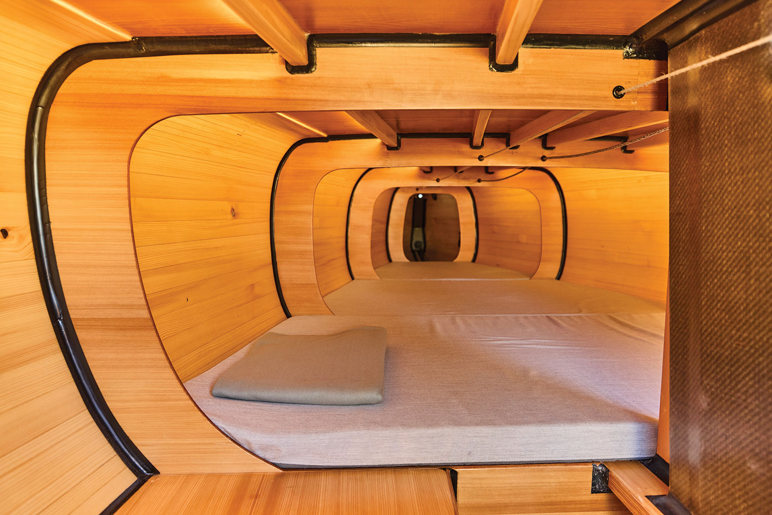

Nico KraussThe varnished V-berth of WOY hull No.1, together with its plywood bulkheads, contrasts with the carbon-fiber keel trunk at right. In this prototype, strip-planking was used; in hull No. 2, larch veneers were used instead. The lines overhead are for the jib’s roller-furler and the gennaker’s tack line.

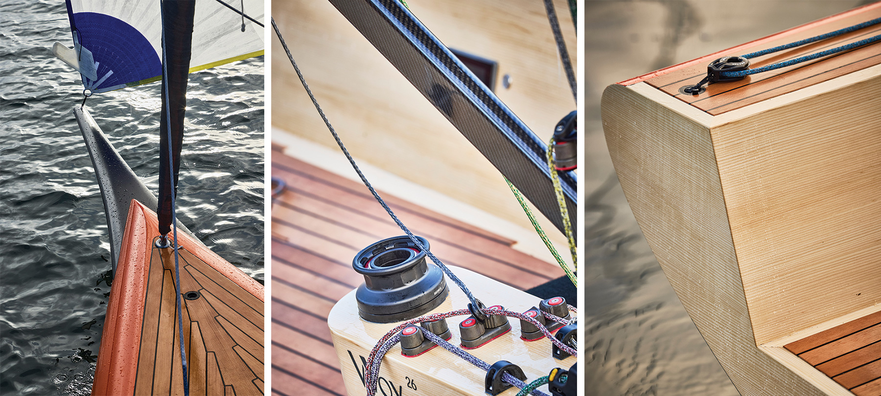

Nico KraussLeft—The WOY’s gennaker tacks to the fixed carbon-fiber bowsprit, while the jib’s roller-furling gear is below the sprung-planked Douglas-fir deck. Middle—The control-line console has a single winch for handling all halyard and trim lines. Right—The center console, transom, and cockpit sides are veneered with silver fir.

Nico Krauss (both)Left—Forward of the mast, the self-tending jib’s sheet is controlled by a traveler block mounted on a curved track. To the right, the visible slot allows the lifting keel to be raised. Right—Instead of fixed cleats, which might disturb the smooth deck surface, WOY has “click-system” fittings. The hull color—called “sunrise”—was achieved with vinyl-wrap finish.

Jan ordered a building form from Knierim Yacht Building in Kiel, taking advantage of that company’s five-axis CNC milling machine to make a precise jig of composite materials following Martin’s digital plans. Two such jigs—one for the hull and one for the deck—used for hull No. 2 will be the basis for all future WOY 26s. The precision of the plans and CNC cutting allow the deck assembly to be wedded seamlessly to the hull.
Next, Jan and his team selected the 2.5mm-thick (³⁄₃₂″) larch planking veneers. Especially for the innermost layer, which was laid longitudinally and would be visible from the interior, the veneers were first laid out on the workshop floor. The jig was treated with a release agent to prevent epoxy-soaked veneers from bonding to it. Then, the first layer of planking was stapled to the jig, followed by the second and third layers on opposing diagonals and the final fourth layer, which was again longitudinal.
By April, hull No. 2 was ready for the vacuum infusion of epoxy. The outer veneer layer was covered with a mesh film at several critical areas for increased pressure on the hull. Finally, the hull was sealed with a greenish film (visible in the photographs below). Four tubes were fixed slightly below the edge of the planking and connected to a pot containing epoxy. Calculations showed that 40 to 50kg (88 to 110 lbs) of epoxy would be needed. Jan used a special low-viscosity bio-epoxy, a blend of resin and hardener that has low crude-oil content.
Nico KraussJan Bruegge enjoys a singlehanded sundown sail on the Schlei inlet; on other occasions his son assumes the role of bowman.
More tubes were fitted along the keel and held in place and made airtight with butyl tape. These tubes were connected to the vacuum pump and finally to a so-called “epoxy trap” to collect excess epoxy. All of the tubes were equipped with valves to control the flow of epoxy during the infusion.
The pump was started with a vacuum pressure close to 1 bar (14.5 psi). In barometric measure, a vacuum pump at 0.9 bar creates a pressure of 9 tons per square meter (184 lbs per sq ft). The fluid epoxy is sucked upward through the plank edges. In Jan’s method—and this is the game changer—grooves less than 1mm deep (about ¹⁄32″) were cut into the veneers to facilitate flow. Slowly, the veneer layers filled, and in less than two hours the hull was completely glued with infused epoxy. Jan said he can better control epoxy flow for precise penetration of the wood when the epoxy is sucked upward rather than flowing downward. Jan was so confident for WOY No. 2 that he invited Germany’s largest yachting magazine to observe the process.
After the epoxy had set, the green film was removed, and the hull was “post-cured” by warming the ambient air to 55°C (131°F), which allowed the infused epoxy to fully cure. Jan raved about how little filling and sanding were required afterward, a testament to the jig’s perfect surface.
